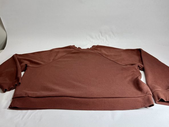

    • Lay your crewneck on a flat surface.

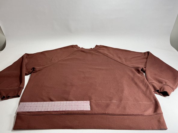

    • Find your new desired length and mark it with chalk.
    • Using your chalk mark, use a ruler to mark across the width of your crewneck.

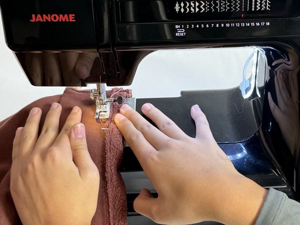

  9. How to Shorten a Sweatshirt Using the Original Hem: 步骤 9 中的图像 1,2 How to Shorten a Sweatshirt Using the Original Hem: 步骤 9 中的图像 2,2
    • Sew one inch away from the edge, removing the pins as you go.
    • This step can also be done by hand with thread and a needle.
