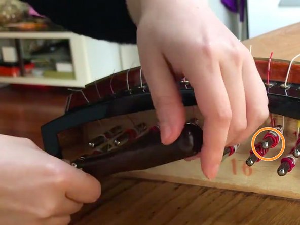

  2. How to Replace the Strings on a Zheng: 步骤 2 中的图像 1,3 How to Replace the Strings on a Zheng: 步骤 2 中的图像 2,3 How to Replace the Strings on a Zheng: 步骤 2 中的图像 3,3
    • Using the zheng wrench, loosen the tuning pins by counterclockwise direction.
    • Turn the pin until there are three loops of the string wound remaining around the pin.
    • Remove the string from the pin.
    • Remove the string at the end side as well.

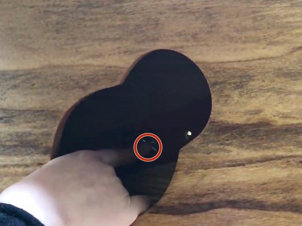

  3. How to Replace the Strings on a Zheng: 步骤 3 中的图像 1,1
    • Use a dry cloth to clean the dust under the position of the old string.

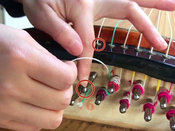

  5. How to Replace the Strings on a Zheng: 步骤 5 中的图像 1,2 How to Replace the Strings on a Zheng: 步骤 5 中的图像 2,2
    • Flip the zheng to the back of the head side and insert the other side of the string into the corresponding hole of zheng and the pin.
    • Coil the string tightly around the pin, use the zheng wrench to tight the pin.
