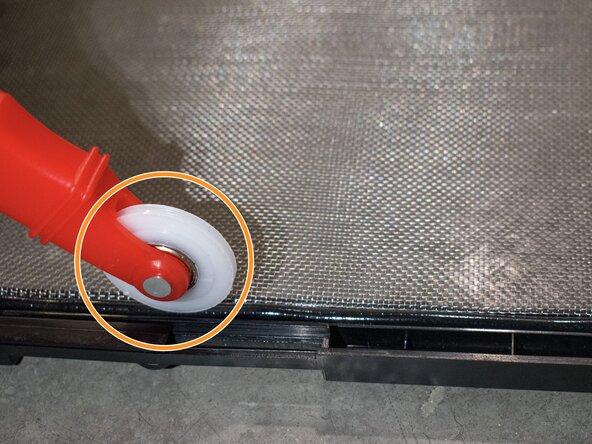

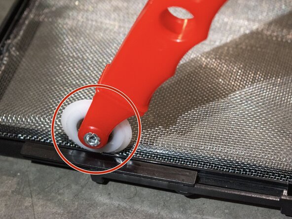

    • Spline roller:
    • We will use "Side A" (circled Red) to refer to the side with the outward-curved edge
    • We will use "Side B" (circled Orange) to refer to the side with a groove.

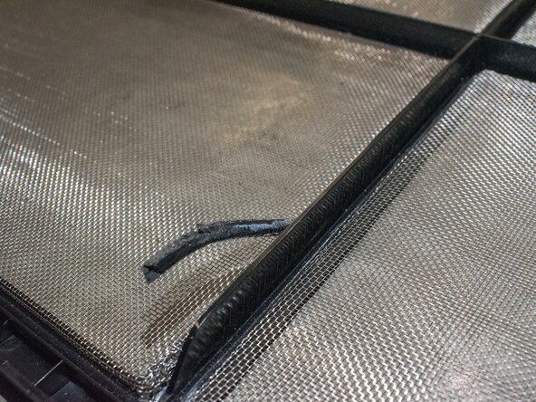

    • Pull out the spline from the frame of the lid.
    • Carefully remove the damaged mesh.

    • Flip the mesh material and the lid frame so that the mesh is now on top of the frame.
    • Using Side A of the spline roller, press the mesh into the frame without the spline.
    • Line the frame with the spline and use Side B of the spline roller to press it in again.
