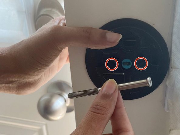

    • Unscrew the lockbolt of the old door and remove it.

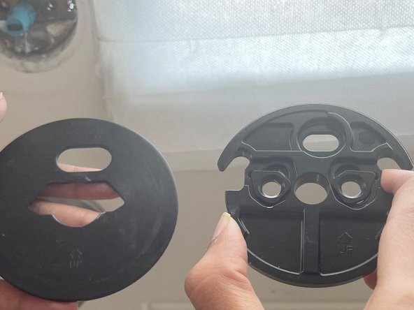

    • Match the adapter to a position where it fits into the middle hole of the door’s lock spot.

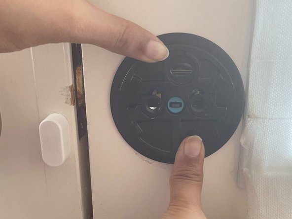

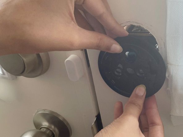

  3. How to Replace a Manual Door Lock With An August (4th Gen.) Smart Lock: 步骤 3 中的图像 1,2 How to Replace a Manual Door Lock With An August (4th Gen.) Smart Lock: 步骤 3 中的图像 2,2
    • Attach the two door mounting plates together, aligning the holes between the two plates.

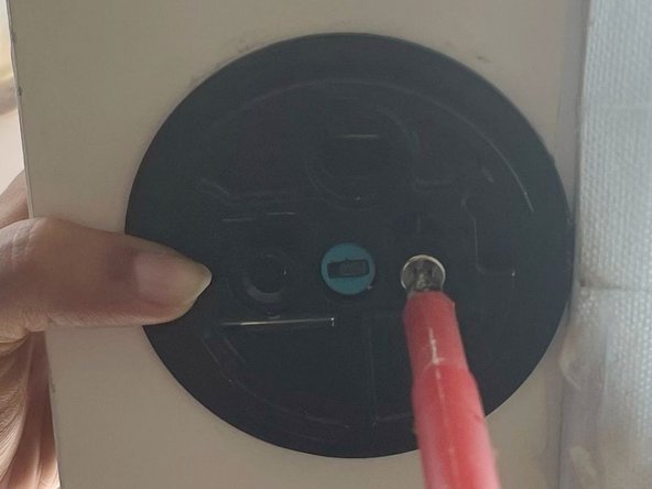

  4. How to Replace a Manual Door Lock With An August (4th Gen.) Smart Lock: 步骤 4 中的图像 1,2 How to Replace a Manual Door Lock With An August (4th Gen.) Smart Lock: 步骤 4 中的图像 2,2
    • Once attached together, flip it the other way and attach it to the lock spot.

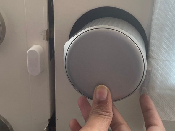

  5. How to Replace a Manual Door Lock With An August (4th Gen.) Smart Lock: 步骤 5 中的图像 1,3 How to Replace a Manual Door Lock With An August (4th Gen.) Smart Lock: 步骤 5 中的图像 2,3 How to Replace a Manual Door Lock With An August (4th Gen.) Smart Lock: 步骤 5 中的图像 3,3
    • Screw the screws back in.

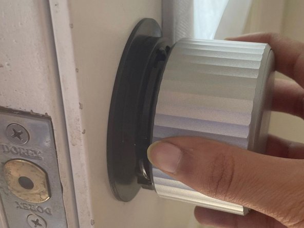

  6. How to Replace a Manual Door Lock With An August (4th Gen.) Smart Lock: 步骤 6 中的图像 1,3 How to Replace a Manual Door Lock With An August (4th Gen.) Smart Lock: 步骤 6 中的图像 2,3 How to Replace a Manual Door Lock With An August (4th Gen.) Smart Lock: 步骤 6 中的图像 3,3

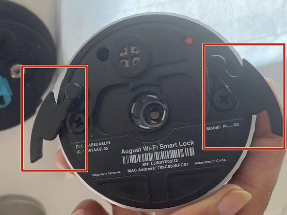

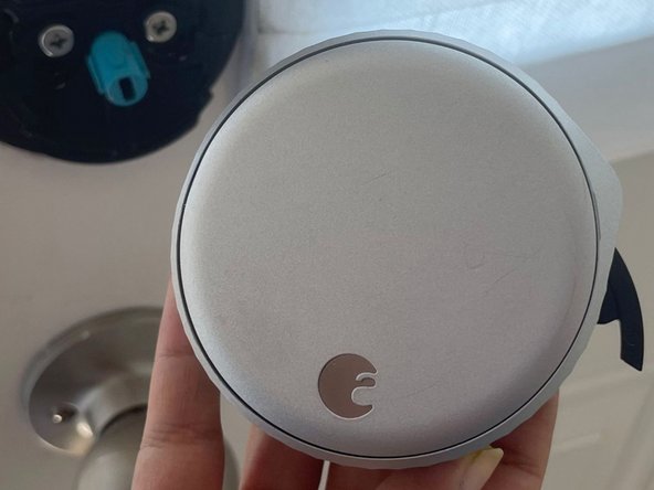

    • Flip your August Smart Lock (4 Gen.) so that the back faces the door.
    • Make sure that both of its side wing latches are still open.

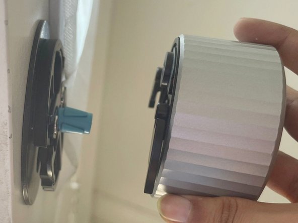

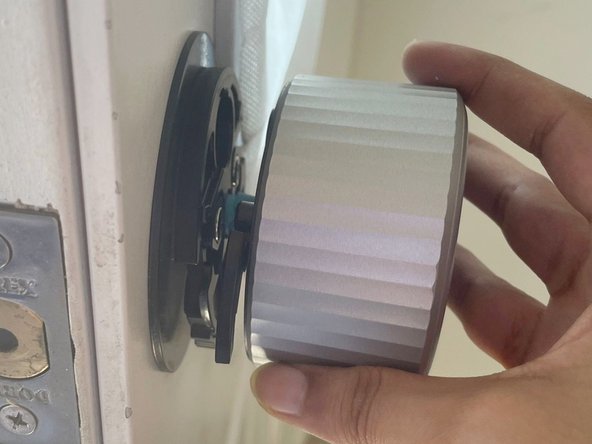

  7. How to Replace a Manual Door Lock With An August (4th Gen.) Smart Lock: 步骤 7 中的图像 1,3 How to Replace a Manual Door Lock With An August (4th Gen.) Smart Lock: 步骤 7 中的图像 2,3 How to Replace a Manual Door Lock With An August (4th Gen.) Smart Lock: 步骤 7 中的图像 3,3
    • Attach the lock to the mounting plates, matching it in the center of the adapter’s tailpiece shape to see how it fits.
    • This may take some rotating to see how it can fit on best.

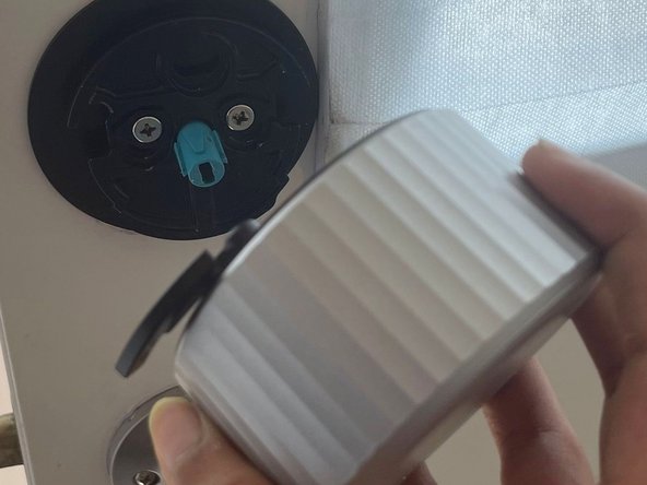

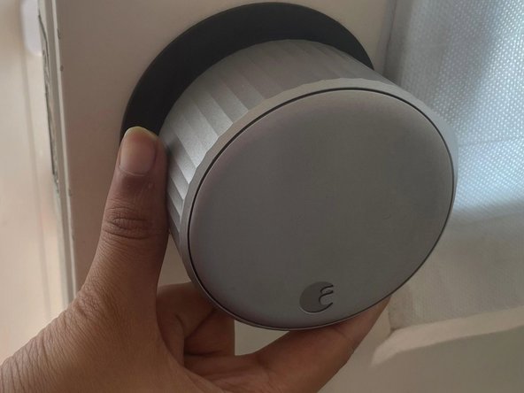

  8. How to Replace a Manual Door Lock With An August (4th Gen.) Smart Lock: 步骤 8 中的图像 1,2 How to Replace a Manual Door Lock With An August (4th Gen.) Smart Lock: 步骤 8 中的图像 2,2
    • Once fit, proceed to close both of the open wing latches on the smart lock.

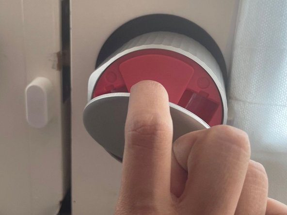

  9. How to Replace a Manual Door Lock With An August (4th Gen.) Smart Lock: 步骤 9 中的图像 1,3 How to Replace a Manual Door Lock With An August (4th Gen.) Smart Lock: 步骤 9 中的图像 2,3 How to Replace a Manual Door Lock With An August (4th Gen.) Smart Lock: 步骤 9 中的图像 3,3

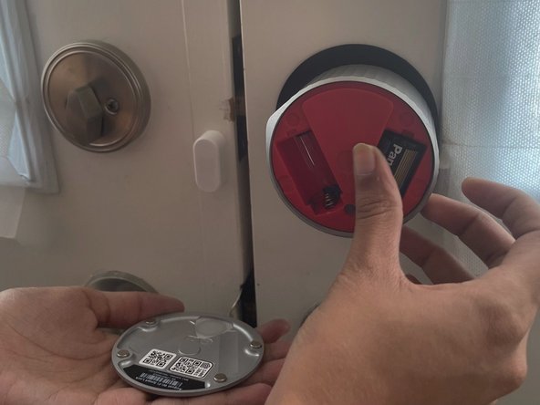

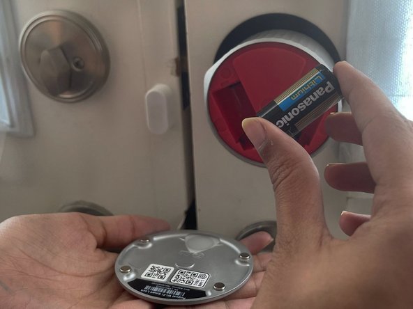

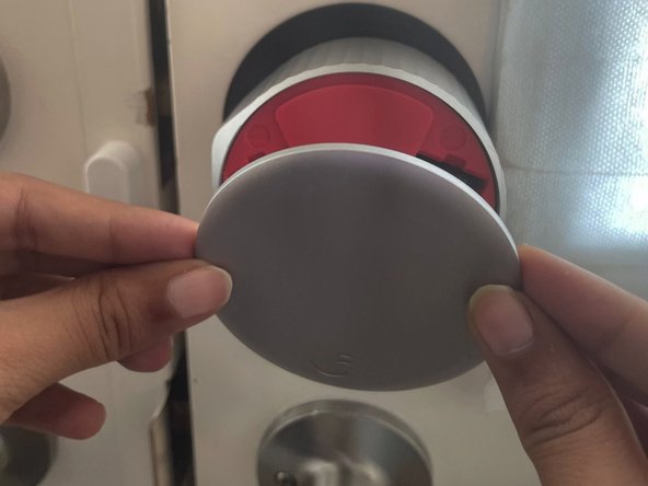

    • Gently push on the ‘August’ logo on the front cover of the electronic lock to lift the front cover (the magnetic buckle).
    • Here, you will find the batteries’ placement area.

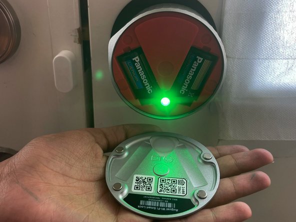

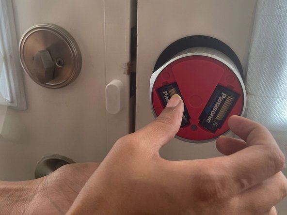

  10. How to Replace a Manual Door Lock With An August (4th Gen.) Smart Lock: 步骤 10 中的图像 1,3 How to Replace a Manual Door Lock With An August (4th Gen.) Smart Lock: 步骤 10 中的图像 2,3 How to Replace a Manual Door Lock With An August (4th Gen.) Smart Lock: 步骤 10 中的图像 3,3
    • If sealed, remove/tear off the plastic seal, then put the given lithium batteries in their designated area.
    • Make sure to place them the right side up - keep in mind that the negative attracts the positive.
  11. How to Replace a Manual Door Lock With An August (4th Gen.) Smart Lock: 步骤 11 中的图像 1,2 How to Replace a Manual Door Lock With An August (4th Gen.) Smart Lock: 步骤 11 中的图像 2,2
    • After doing so, you’ll see the ‘August’ Smart Lock flash a green light.
    • Once that happens, put the front cover back on.

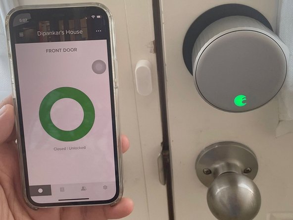

    • Download and configure the August Smart Lock application on your cellular device.
    • Follow the on-screen instructions to connect to your lock.
    • Pay attention to the light coming from the logo as you proceed.

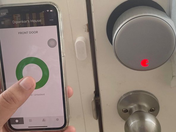

  13. How to Replace a Manual Door Lock With An August (4th Gen.) Smart Lock: 步骤 13 中的图像 1,2 How to Replace a Manual Door Lock With An August (4th Gen.) Smart Lock: 步骤 13 中的图像 2,2

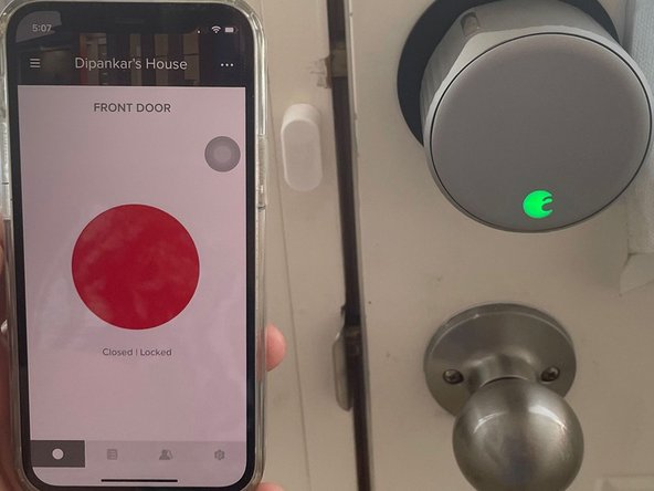

    • Once done, test the application by pressing your phone screen to lock your door.
  14. How to Replace a Manual Door Lock With An August (4th Gen.) Smart Lock: 步骤 14 中的图像 1,2 How to Replace a Manual Door Lock With An August (4th Gen.) Smart Lock: 步骤 14 中的图像 2,2
    • Test the application again by pressing your phone screen to unlock your door this time.

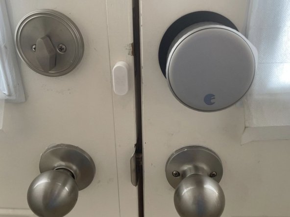

  15. How to Replace a Manual Door Lock With An August (4th Gen.) Smart Lock: 步骤 15 中的图像 1,2 How to Replace a Manual Door Lock With An August (4th Gen.) Smart Lock: 步骤 15 中的图像 2,2

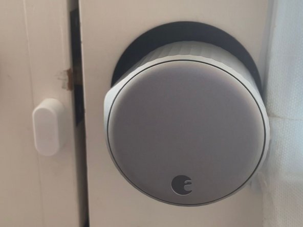

    • Your new Wi-Fi controlled smart lock should now be ready to use at any time.
