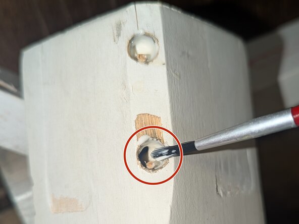

  8. How to Repair Loose Threaded Bolts in a Wooden Chair Leg: 步骤 8 中的图像 1,3 How to Repair Loose Threaded Bolts in a Wooden Chair Leg: 步骤 8 中的图像 2,3 How to Repair Loose Threaded Bolts in a Wooden Chair Leg: 步骤 8 中的图像 3,3
    • Add a liberal amount of wood glue into the bolt hole.
    • With a small paint brush, spread the glue evenly throughout the bolt hole.

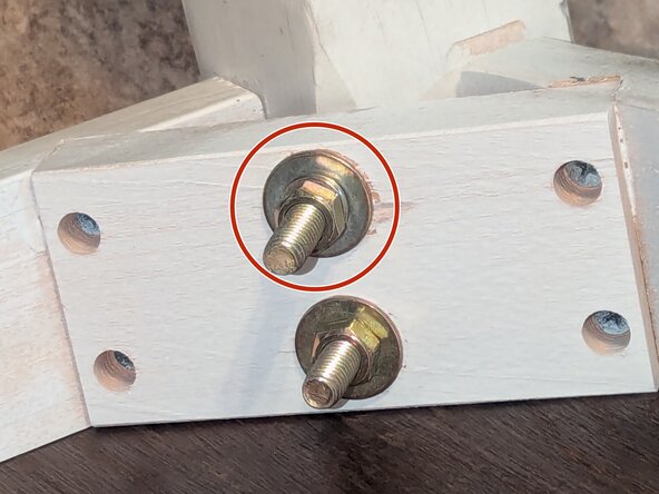

  11. How to Repair Loose Threaded Bolts in a Wooden Chair Leg: 步骤 11 中的图像 1,1
    • After the glue has cured, reinsert the leg into the bottom of the chair.
    • Add the washer and nut to the threaded bolt and finger tighten.
    • The leg will be loose! Hold it steady with one hand to prevent it from shifting and causing damage to the chair or injury to yourself.
  12. How to Repair Loose Threaded Bolts in a Wooden Chair Leg: 步骤 12 中的图像 1,1
    • Select the correct socket size and firmly tighten the nuts to securely attach the leg to the chair base.
    • Do not over-tighten the nuts. This can strip the threaded bolt holes or crack the wooden crossbar that supports the leg. Tighten just enough to secure the leg firmly without putting too much pressure on the wood.
