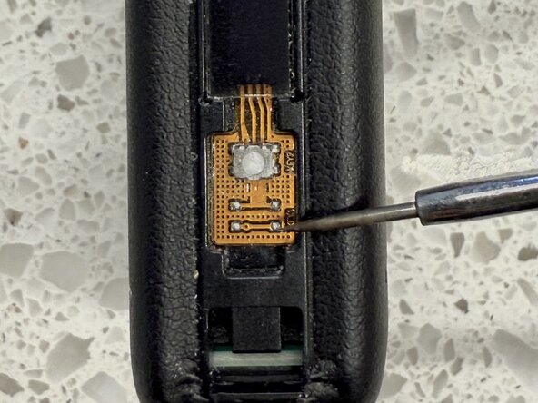

  3. How to Fix the Adjust Button on a Smok Nord GT: 步骤 3 中的图像 1,1
    • Use a cotton swab damp with isopropyl alcohol to clean the button area.
  4. How to Fix the Adjust Button on a Smok Nord GT: 步骤 4 中的图像 1,3 How to Fix the Adjust Button on a Smok Nord GT: 步骤 4 中的图像 2,3 How to Fix the Adjust Button on a Smok Nord GT: 步骤 4 中的图像 3,3
    • If you continue to have trouble with the button manually, use this step to switch the vape to automatic mode.
    • To switch to automatic mode, insert a needle into the the tiny hole above the main button and hold for 3 seconds.
  5. How to Fix the Adjust Button on a Smok Nord GT: 步骤 5 中的图像 1,3 How to Fix the Adjust Button on a Smok Nord GT: 步骤 5 中的图像 2,3 How to Fix the Adjust Button on a Smok Nord GT: 步骤 5 中的图像 3,3
    • Reassemble the vape.
    • Note: You no longer need to manually adjust the voltage, the device will now automatically adjust based on your smoking style and nicotine type.
    • If you want to adjust the voltage manually, you need to press the button and the small piece of metal under the button simultaneously three times.
