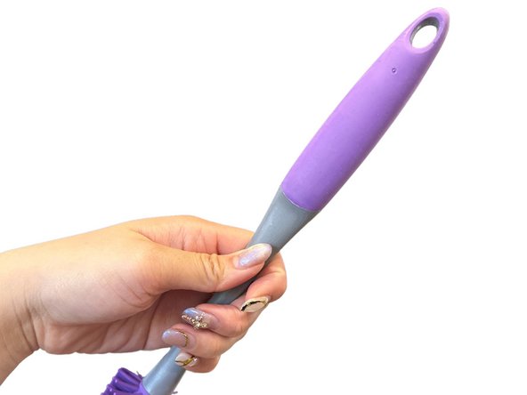

    • Find a tool with a small handle that fits in the space under the auger.
    • Example: A dish-washing brush handle.

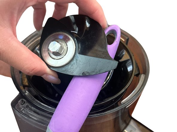

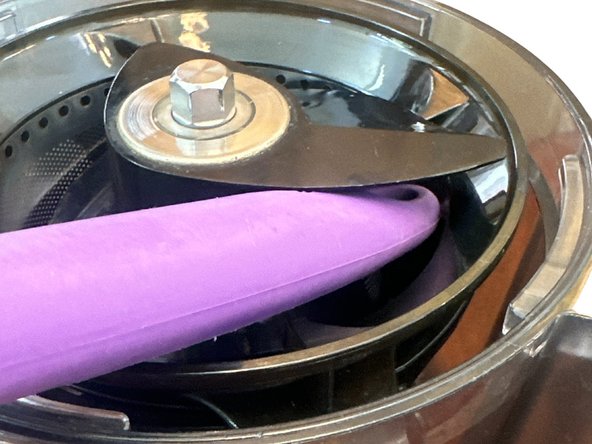

  2. How to Fix a Stuck Auger in a Nama J2 Juicer: 步骤 2 中的图像 1,3 How to Fix a Stuck Auger in a Nama J2 Juicer: 步骤 2 中的图像 2,3 How to Fix a Stuck Auger in a Nama J2 Juicer: 步骤 2 中的图像 3,3
    • Insert the handle or tool of choice underneath the longer part of the bottom of the auger.

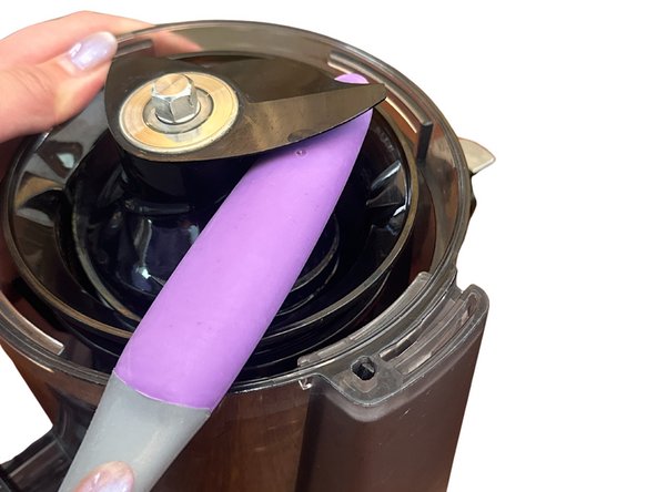

  3. How to Fix a Stuck Auger in a Nama J2 Juicer: 步骤 3 中的图像 1,1
    • Lift up the handle/tool towards you with slight force.
    • The auger should start lift up as you do this.
  4. How to Fix a Stuck Auger in a Nama J2 Juicer: 步骤 4 中的图像 1,1
    • Hold and lift up the auger as you continue to use your tool to remove it.
  5. How to Fix a Stuck Auger in a Nama J2 Juicer: 步骤 5 中的图像 1,1
    • Now that it's loosened, lift up the auger.
  6. How to Fix a Stuck Auger in a Nama J2 Juicer: 步骤 6 中的图像 1,1
    • Congratulations! Now your auger is no longer stuck.
