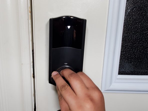

    • Make sure the lock is in the unlock position when you start.
    • Use a Philips #1 screwdriver to remove the two 8 mm screws from the left and right sides of the lock.

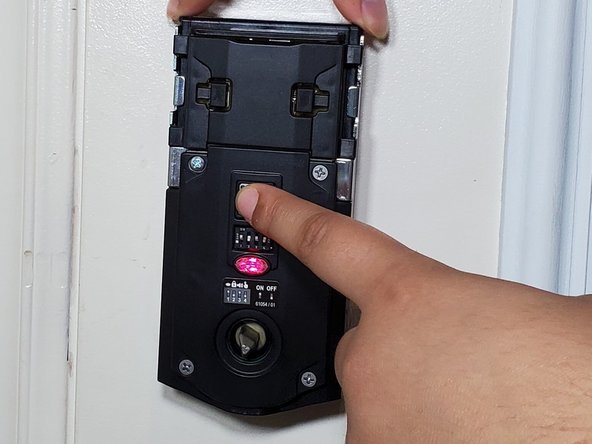

    • Lift the faceplate from the lock.
    • Locate the battery pack stationed at the top of the lock and the programming button at the center of the lock.

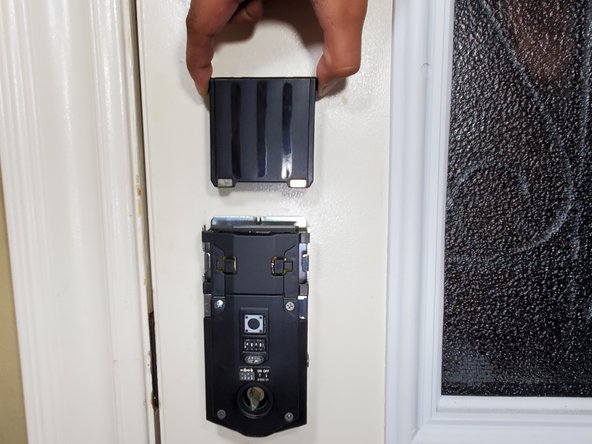

  3. How to Fix a Jammed Weiser SmartCode 10 Touchscreen Door Lock: 步骤 3 中的图像 1,1
    • Pull the battery pack up and off to remove it from the lock housing.
  4. How to Fix a Jammed Weiser SmartCode 10 Touchscreen Door Lock: 步骤 4 中的图像 1,2 How to Fix a Jammed Weiser SmartCode 10 Touchscreen Door Lock: 步骤 4 中的图像 2,2
    • Re-insert the battery pack while holding down the programming button.
    • Ensure the battery pack is fully inserted by pushing it down.
  5. How to Fix a Jammed Weiser SmartCode 10 Touchscreen Door Lock: 步骤 5 中的图像 1,3 How to Fix a Jammed Weiser SmartCode 10 Touchscreen Door Lock: 步骤 5 中的图像 2,3 How to Fix a Jammed Weiser SmartCode 10 Touchscreen Door Lock: 步骤 5 中的图像 3,3
    • Release the programming button after the indicator light turns red then green.
    • Repeat steps 3 through 5 if the light does not turn green.
  6. How to Fix a Jammed Weiser SmartCode 10 Touchscreen Door Lock: 步骤 6 中的图像 1,2 How to Fix a Jammed Weiser SmartCode 10 Touchscreen Door Lock: 步骤 6 中的图像 2,2
    • Press the program button again to allow the Smartlock to re-calibrate and reprogram itself.
    • The lock will lock and unlock a few times to calibrate and will remain in the lock position when the calibration is complete.
