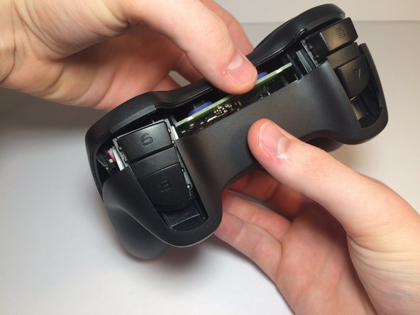

  3. How to Fix Sticky Controls on a Logitech RumblePad2: 步骤 3 中的图像 1,2 How to Fix Sticky Controls on a Logitech RumblePad2: 步骤 3 中的图像 2,2
    • Remove the back panel from the controller.
    • It is easiest to first pry off the panel from the bottom, as shown in the pictures.
    • If using a tool to pry the panel off, do not insert the tool far into the controller. This may damage the motherboard.

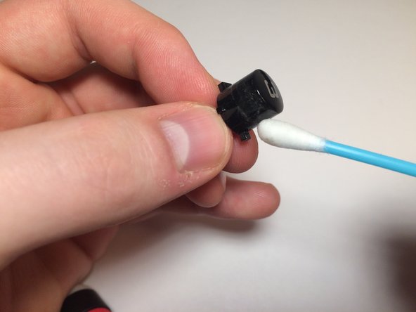

  8. How to Fix Sticky Controls on a Logitech RumblePad2: 步骤 8 中的图像 1,2 How to Fix Sticky Controls on a Logitech RumblePad2: 步骤 8 中的图像 2,2
    • Remove the buttons from their slots by pushing them in from the front.
    • Wipe the buttons with a wet cotton swab or paper towel
