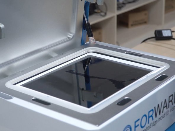

    • After laminating OCA, we put iPad glass with OCA into CEO-2+ Lamination Machineto remove bubbles.
    • Then, select Flat LCD laminate mode. Click “Settings” button. And set bubble removing time to 300s. After time setting, return to Flat LCD interface.
    • Then select bubble mode and press “Start” button. Once time up, take out affixed iPad glass.
    • You can see the defoaming effect is super good as following picture.

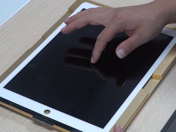

    • Place iPad LCD onto specialized iPad positioning mold.
    • Then clean up the LCD in advance.
    • And continue to remove affixed glass’s OCA protector film.
    • Once done, align the position, and paste the glass onto LCD.
    • Use a finger to press the middle of the glass. It can make the glass and LCD to be initially attached.

    • Then put the screen into CEO-2+ Lamination Machine for LCD laminating.
    • Return to Flat LCD laminate mode at first. Then click “Settings” button. Set bubble time to 600s, vacuum time to 60s and laminate time to 40s.
    • Once time set, return to Flat LCD laminate interface. And select “Both” mode of laminating and bubble removing. Press “Start” button.
    • Once time up, take out the screen.
    • We can see here that the screen looks perfect, like a new one.
