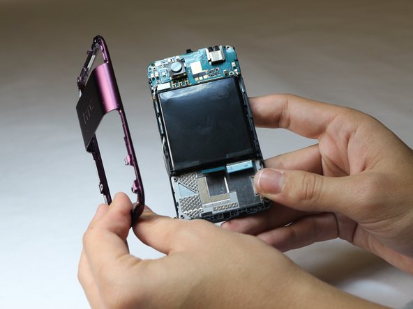

  8. HTC Rhyme Battery Replacement, Removing the Back Plastic Casing: 步骤 8 中的图像 1,3 HTC Rhyme Battery Replacement, Removing the Back Plastic Casing: 步骤 8 中的图像 2,3 HTC Rhyme Battery Replacement, Removing the Back Plastic Casing: 步骤 8 中的图像 3,3
    • Pry the back plastic casing off with your hands.
