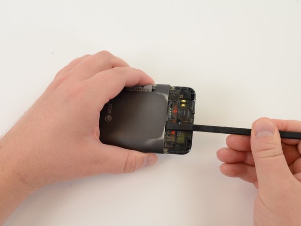

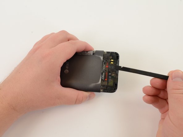

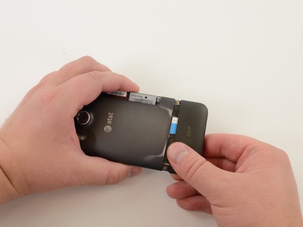

    • Remove battery cover using a plastic opening tool or finger nail.
    • Slide opening tool to release clasps and remove battery cover.

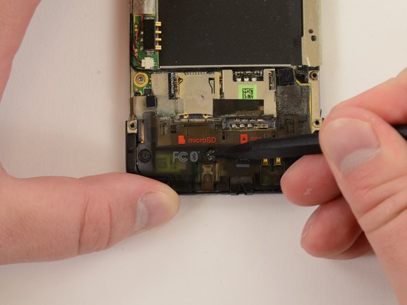

    • Use a curved metal spudger to remove GPS cover.
    • Probe underside of GPS cover until you can force a small opening between GPS cover and back cover of phone.
  7. HTC Inspire 4G Display Assembly Replacement: 步骤 7 中的图像 1,3 HTC Inspire 4G Display Assembly Replacement: 步骤 7 中的图像 2,3 HTC Inspire 4G Display Assembly Replacement: 步骤 7 中的图像 3,3
    • Insert plastic opening tool into gap between GPS cover and back cover of phone. Slide tool along GPS cover and pry the piece off.

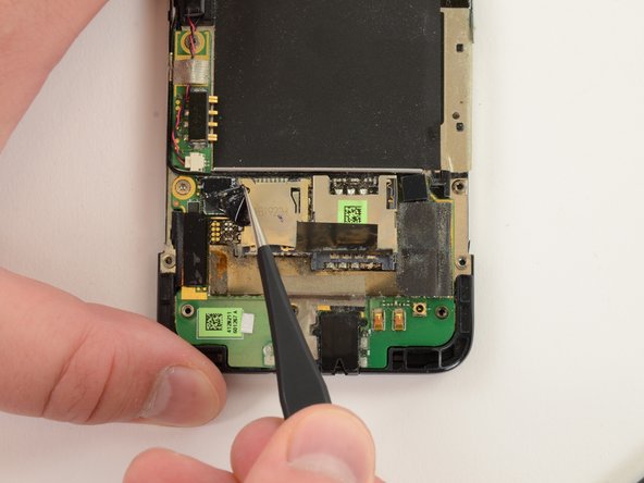

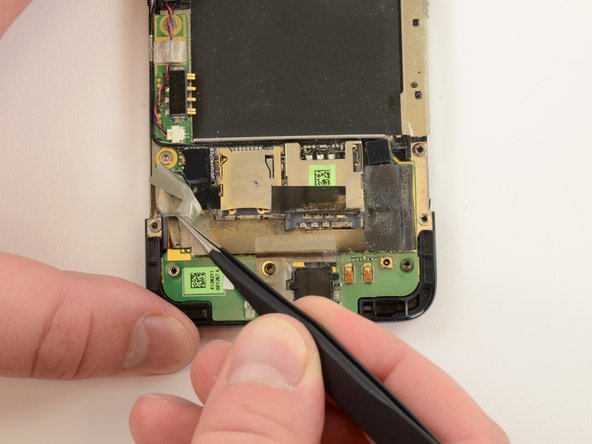

    • Peel off Mylar tape.
  18. HTC Inspire 4G Display Assembly Replacement: 步骤 18 中的图像 1,2 HTC Inspire 4G Display Assembly Replacement: 步骤 18 中的图像 2,2
    • Peel off electrical tape.

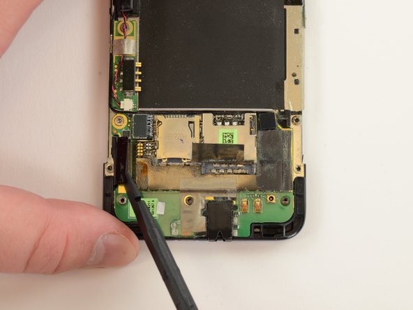

    • Pry display assembly connector off of lower logic board.
  20. HTC Inspire 4G Display Assembly Replacement: 步骤 20 中的图像 1,2 HTC Inspire 4G Display Assembly Replacement: 步骤 20 中的图像 2,2

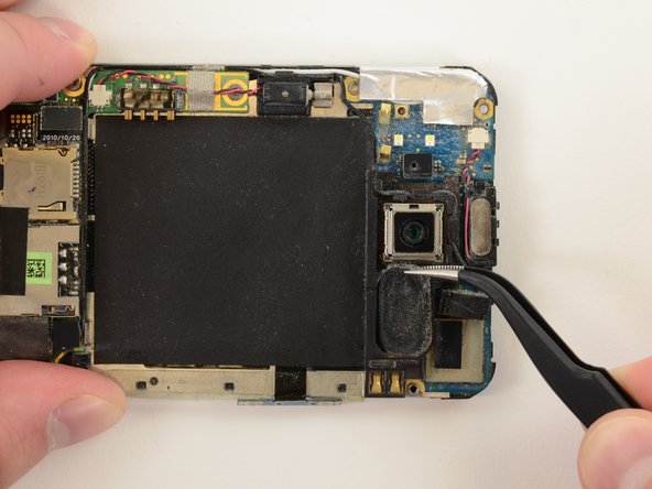

    • Pry off Bluetooth coaxial cable connector.
    • Unwind Bluetooth coaxial cable from plastic camera shield.
  25. HTC Inspire 4G Display Assembly Replacement: 步骤 25 中的图像 1,3 HTC Inspire 4G Display Assembly Replacement: 步骤 25 中的图像 2,3 HTC Inspire 4G Display Assembly Replacement: 步骤 25 中的图像 3,3
    • Pry off plastic camera shield.

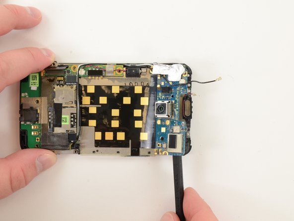

    • Gently separate upper logic board from mid chassis. The upper logic board is held to the mid chassis by copious amounts of strong adhesive.
  28. HTC Inspire 4G Display Assembly Replacement: 步骤 28 中的图像 1,2 HTC Inspire 4G Display Assembly Replacement: 步骤 28 中的图像 2,2
    • Gently separate lower logic board from mid chassis. The lower logic board is held to the mid chassis by copious amounts of strong adhesive.
  29. HTC Inspire 4G Display Assembly Replacement: 步骤 29 中的图像 1,1
    • Once the adhesive-laden logic boards are separated from the mid chassis, the entire assembly easily comes off.
    • Be careful when handing the logic board assembly. We could have separated out each part, but decided it was a waste of time. The cost of cutting this corner is extra care when handling the logic board assembly.
