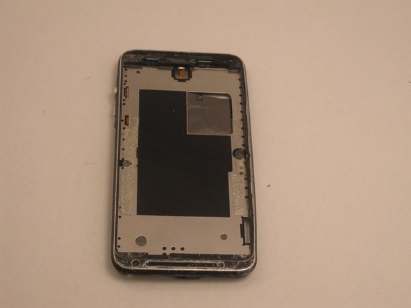

    • At this point the motherboard is almost fully detached.
    • Lift the motherboard and using precision tweezers, peel up the insulation cover on the bottom left corner.
  9. HTC Evo 3D Screen Replacement: 步骤 9 中的图像 1,3 HTC Evo 3D Screen Replacement: 步骤 9 中的图像 2,3 HTC Evo 3D Screen Replacement: 步骤 9 中的图像 3,3
    • Disconnect the two ribbons on the backside of the mother board using precision tweezers.
    • Disconnect the Cellular/WIFI antenna by pulling directly up on the black wire.
    • The motherboard will now be free from the rest of the phone.

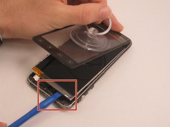

  11. HTC Evo 3D Screen Replacement: 步骤 11 中的图像 1,2 HTC Evo 3D Screen Replacement: 步骤 11 中的图像 2,2
    • Use the suction cup to remove the screen off the device.
    • Be careful not to tear off the flex cable.
    • After lifting the screen, begin prying the digitizer using a plastic opening tool.
    • Continue with this process around the entire perimeter of the phone.
