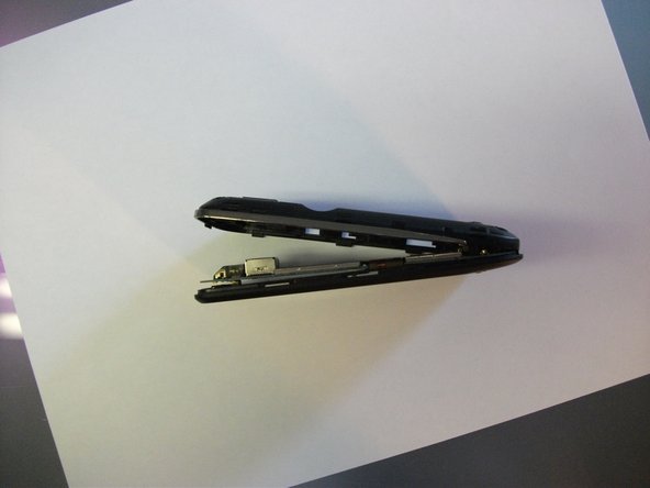

  3. HTC Droid Eris Digitizer or LCD Screen Replacement: 步骤 3 中的图像 1,2 HTC Droid Eris Digitizer or LCD Screen Replacement: 步骤 3 中的图像 2,2
    • Insert a spudger or a pry pick between the front cover and the chrome on the sides of the device. Work the tool from the bottom on one side, to the top, and then back around to the bottom on the other side.
    • Remove the back cover by lifting from the top.

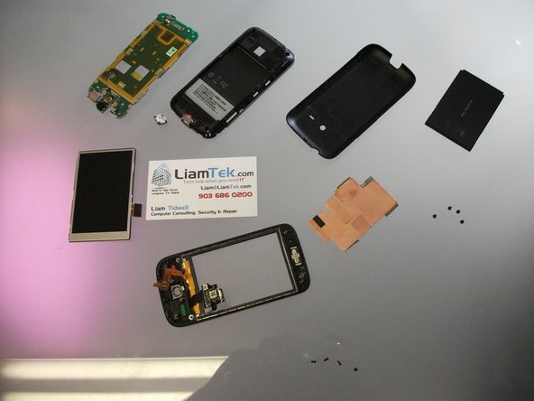

  4. HTC Droid Eris Digitizer or LCD Screen Replacement: 步骤 4 中的图像 1,1
    • Remove the RF shield by carefully peeling off the 4 pieces of metallic tape.
    • Don't damage or discard the 4 pieces of tape and the RF shield. You will need to reuse these items in later steps.

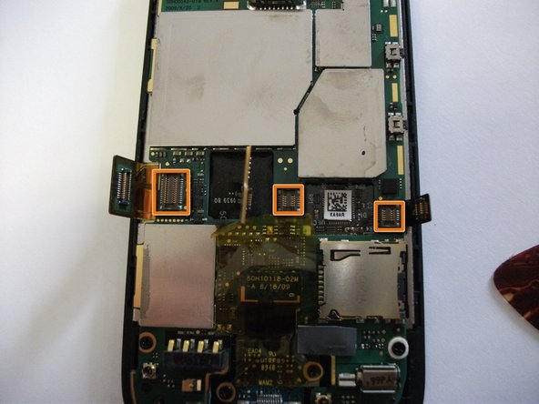

  5. HTC Droid Eris Digitizer or LCD Screen Replacement: 步骤 5 中的图像 1,2 HTC Droid Eris Digitizer or LCD Screen Replacement: 步骤 5 中的图像 2,2
    • Use a spudger or a pry pick to release the 3 connectors marked in red in the photo. (The middle connector will be covered with a piece of tape.)

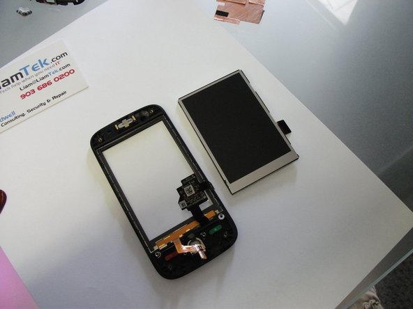

  9. HTC Droid Eris Digitizer or LCD Screen Replacement: 步骤 9 中的图像 1,3 HTC Droid Eris Digitizer or LCD Screen Replacement: 步骤 9 中的图像 2,3 HTC Droid Eris Digitizer or LCD Screen Replacement: 步骤 9 中的图像 3,3
    • Carefully separate the face of the phone from the LCD screen by using a spudger or a pry pick.
    • Replace the broken LCD or digitizer and reassemble in reverse.
    • If replacing the digitizer, you may either replace the entire front as part of an assembly or use a heat gun to separate and replace the glass only.
