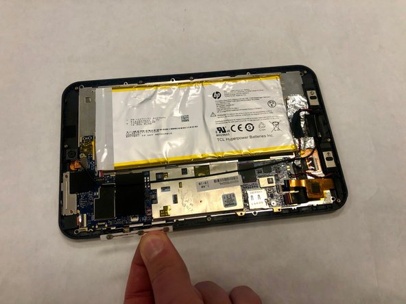

  1. HP Stream 8 Button Board Replacement, Button Board: 步骤 1 中的图像 1,1
    • Use your nail to pry up the back cover of the device.

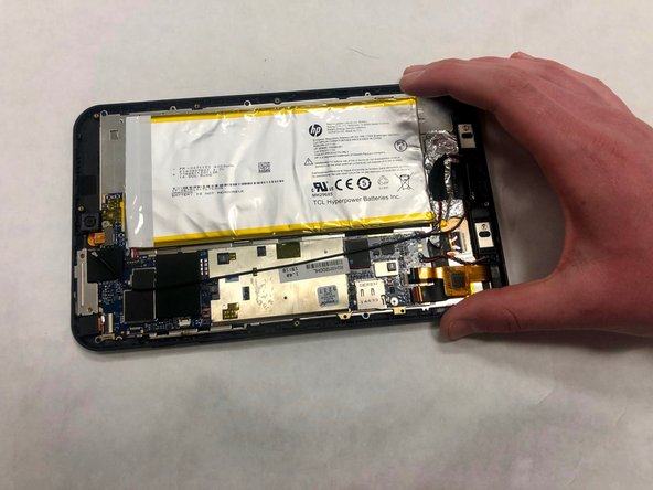

  2. HP Stream 8 Button Board Replacement: 步骤 2 中的图像 1,1
    • Fully remove the back cover.
  3. HP Stream 8 Button Board Replacement: 步骤 3 中的图像 1,3 HP Stream 8 Button Board Replacement: 步骤 3 中的图像 2,3 HP Stream 8 Button Board Replacement: 步骤 3 中的图像 3,3
    • Remove the 10 3mm screws using the Phillips #00 screwdriver.
  4. HP Stream 8 Button Board Replacement: 步骤 4 中的图像 1,2 HP Stream 8 Button Board Replacement: 步骤 4 中的图像 2,2
    • Pry up the inside cover the same way as you did with the back cover and fully remove it.
  5. HP Stream 8 Button Board Replacement: 步骤 5 中的图像 1,2 HP Stream 8 Button Board Replacement: 步骤 5 中的图像 2,2
    • Disconnect the button board from the motherboard and remove it.
