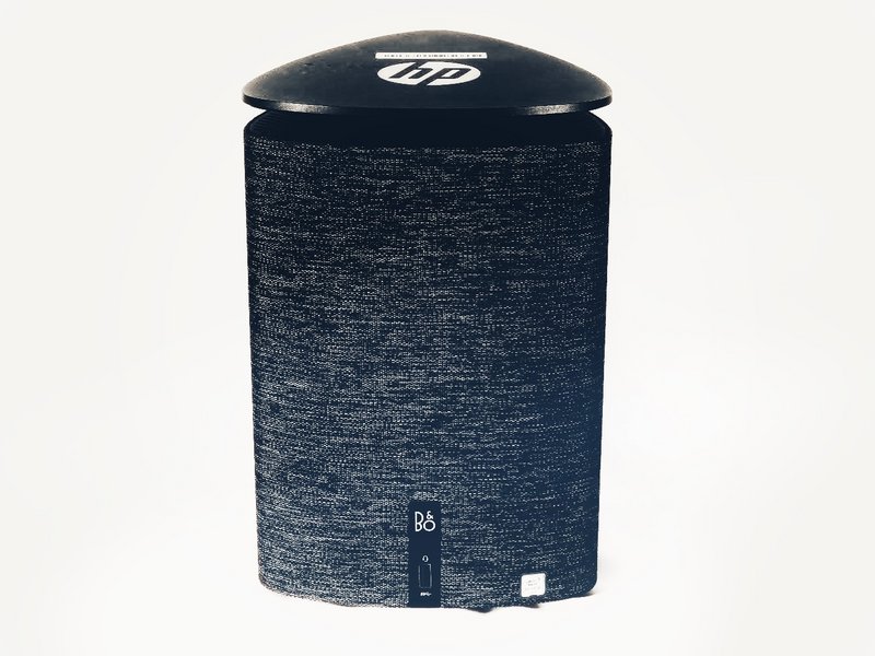

This guide will help give direction to properly remove the speaker from your HP Pavilion Wave Desktop PC. Tools required for this removal include Phillips and Torx head screwdrivers, metal and plastic prying tools, and a magnetic arrangement pad.
