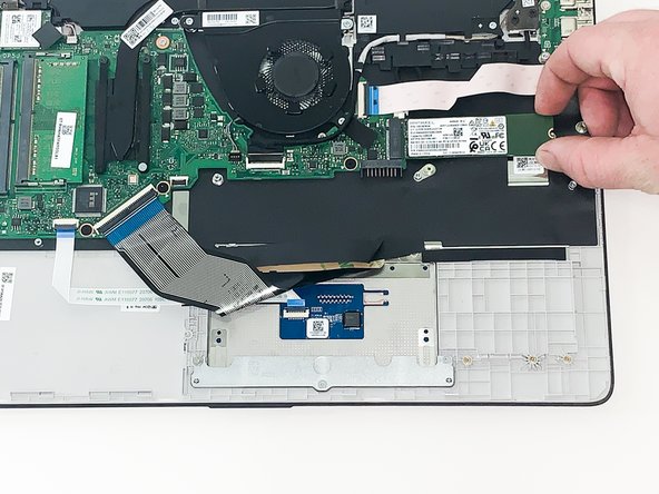

  6. HP 15-ef2025nr SSD Replacement, SSD: 步骤 6 中的图像 1,2 HP 15-ef2025nr SSD Replacement, SSD: 步骤 6 中的图像 2,2
    • Remove the single 1 mm screw securing the SSD.
    • Gently remove the SSD by pulling it directly out of its port.
