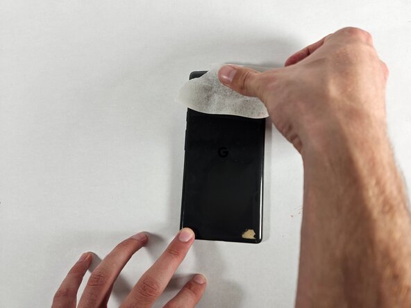

    • Use the wet wipe included in your kit to clean the rear camera glass panel.
    • Dry off the rear camera glass panel with the dry wipe.

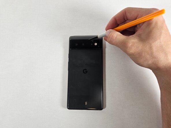

    • Carefully cut around the edges of the phone's rear glass panel using an X-Acto knife.
    • Caution: Hazardous situation which involves a sharp utensil and glass fragments.

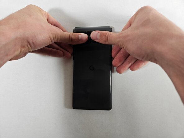

    • Using the tweezers, begin chipping and tweezing away at the cracked region.
    • Caution: Shards and shrapnel can splinter off of the panel.
    • Keep some masking tape near to be able to pick up shrapnel without injuring yourself.

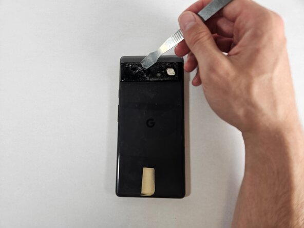

    • Use the metal spudger to remove the larger pieces of the glass to expose the layer underneath.
    • Caution: Hastily removing sharp fragments pieces could result in injury.

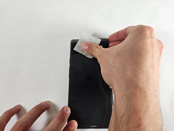

    • Use the opening tool to remove excess glue leftover from the old glass panel.
    • Perform this step only when all glass has been removed from the camera area.

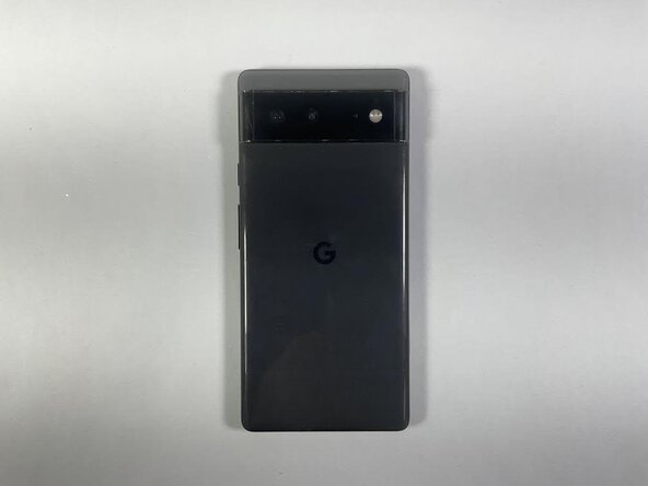

    • Align the glass panel replacement with the exposed camera area.
    • Press the glass panel firmly into the camera area.
    • Do not press too hard to avoid cracking glass from excess pressure.
    • Let the glass panel adhesive dry for approximately two hours before using the phone.
