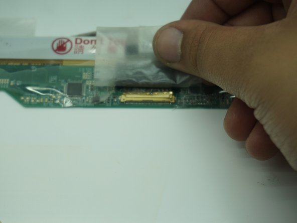

  7. Gateway NV59C66u LCD Display Replacement: 步骤 7 中的图像 1,3 Gateway NV59C66u LCD Display Replacement: 步骤 7 中的图像 2,3 Gateway NV59C66u LCD Display Replacement: 步骤 7 中的图像 3,3
    • Disconnect the LCD cables on the back of the screen and then remove the screen.
    • set the damaged LCD display to the side and grab the new LCD display.
    • Make sure to support the new LCD screen like you did the damaged one, and slowly reconnect the cables to the new display. Make sure the cables are in the right place.
    • set the new LCD screen in the computer make sure it is secure.
    • Screw in all the screws to hold the screen in place.
    • reset the plastic case to hold the screen in place.
    • Put all latches in the lock position and lightly press the plastic border to the screen to make sure it's in place.
