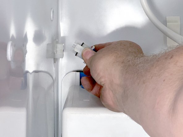

  7. GE Side-By-Side Refrigerator Evaporator Fan Replacement, Disconnect ice maker: 步骤 7 中的图像 1,3 GE Side-By-Side Refrigerator Evaporator Fan Replacement, Disconnect ice maker: 步骤 7 中的图像 2,3 GE Side-By-Side Refrigerator Evaporator Fan Replacement, Disconnect ice maker: 步骤 7 中的图像 3,3
    • Disconnect ice maker plug by loosening the retainer clips by lifting them if possible and then pulling the plug out of the socket. The socket is shown with the plug removed.
    • This may take some force. You can try lifting the retainer clips with a small flat head screwdriver, but access is difficult.
    • Remove the ice maker from the freezer compartment.

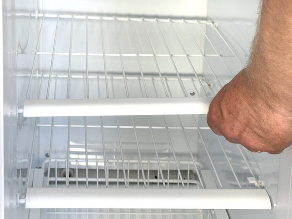

  12. GE Side-By-Side Refrigerator Evaporator Fan Replacement, Remove shelves.: 步骤 12 中的图像 1,2 GE Side-By-Side Refrigerator Evaporator Fan Replacement, Remove shelves.: 步骤 12 中的图像 2,2
    • Lift the right edge of the shelf to free it from the clips which secure it.
    • This may take a bit of force as the clips hold firmly
    • Once the shelf is lifted, move it to the right and free the tabs on the left edge.
    • Remove the shelf.
    • Repeat this for each of the freezer shelves.

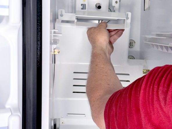

  16. GE Side-By-Side Refrigerator Evaporator Fan Replacement, Remove the evaporator fan cover: 步骤 16 中的图像 1,1
    • Use a 1/4" nut driver to remove the four screws securing the evaporator fan cover to the rear of the refrigerator.
  17. GE Side-By-Side Refrigerator Evaporator Fan Replacement: 步骤 17 中的图像 1,3 GE Side-By-Side Refrigerator Evaporator Fan Replacement: 步骤 17 中的图像 2,3 GE Side-By-Side Refrigerator Evaporator Fan Replacement: 步骤 17 中的图像 3,3
    • Lift the evaporator fan cover upward to free it.
    • Pull the top of the evaporator fan cover forward.
  18. GE Side-By-Side Refrigerator Evaporator Fan Replacement: 步骤 18 中的图像 1,1
    • Remove the evaporator fan cover.

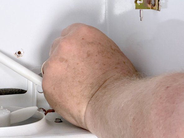

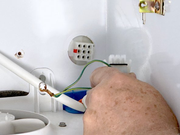

  19. GE Side-By-Side Refrigerator Evaporator Fan Replacement, Disconnect the ground connection: 步骤 19 中的图像 1,2 GE Side-By-Side Refrigerator Evaporator Fan Replacement, Disconnect the ground connection: 步骤 19 中的图像 2,2
    • Use a 1/4" nut driver to disconnect the ground connection next to the evaporator fan housing.
  20. GE Side-By-Side Refrigerator Evaporator Fan Replacement, Disconnect the right hand cable: 步骤 20 中的图像 1,3 GE Side-By-Side Refrigerator Evaporator Fan Replacement, Disconnect the right hand cable: 步骤 20 中的图像 2,3 GE Side-By-Side Refrigerator Evaporator Fan Replacement, Disconnect the right hand cable: 步骤 20 中的图像 3,3
    • Squeeze the release tabs on the connector located to the right of and above the evaporator fan housing.
    • Pull the connector toward you to disconnect it.

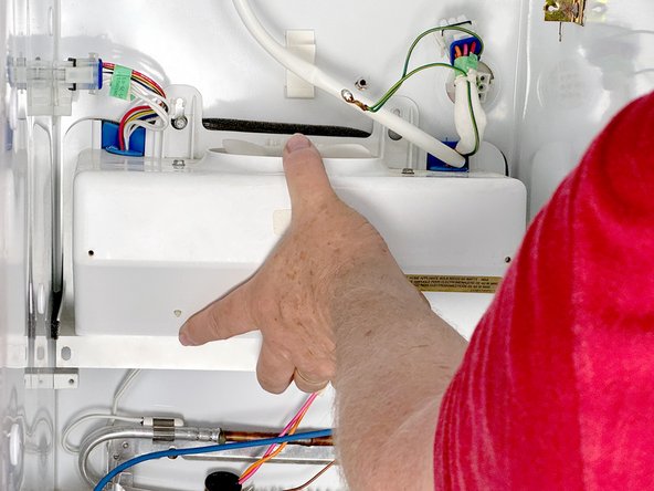

  22. GE Side-By-Side Refrigerator Evaporator Fan Replacement, Unfasten the evaporator fan housing: 步骤 22 中的图像 1,3 GE Side-By-Side Refrigerator Evaporator Fan Replacement, Unfasten the evaporator fan housing: 步骤 22 中的图像 2,3 GE Side-By-Side Refrigerator Evaporator Fan Replacement, Unfasten the evaporator fan housing: 步骤 22 中的图像 3,3
    • Use a 1/4" nut driver to loosen or remove the screws securing the fan housing to the rear wall of the freezer.
    • If you loosened the screws, lift the fan housing until the screws are freed from the slots.
  23. GE Side-By-Side Refrigerator Evaporator Fan Replacement, Reposition the evaporator fan housing: 步骤 23 中的图像 1,3 GE Side-By-Side Refrigerator Evaporator Fan Replacement, Reposition the evaporator fan housing: 步骤 23 中的图像 2,3 GE Side-By-Side Refrigerator Evaporator Fan Replacement, Reposition the evaporator fan housing: 步骤 23 中的图像 3,3
    • Reposition the evaporator fan housing by lifting it and rotating the top toward you to access the evaporator fan assembly retainer screws.

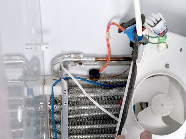

  24. GE Side-By-Side Refrigerator Evaporator Fan Replacement, Unclip the defrost thermostat: 步骤 24 中的图像 1,3 GE Side-By-Side Refrigerator Evaporator Fan Replacement, Unclip the defrost thermostat: 步骤 24 中的图像 2,3 GE Side-By-Side Refrigerator Evaporator Fan Replacement, Unclip the defrost thermostat: 步骤 24 中的图像 3,3
    • Defrost thermostat location
    • Pull the defrost thermostat upward to unclip it from the evaporator tubing.
  25. GE Side-By-Side Refrigerator Evaporator Fan Replacement, Unclip the defrost thermistor: 步骤 25 中的图像 1,3 GE Side-By-Side Refrigerator Evaporator Fan Replacement, Unclip the defrost thermistor: 步骤 25 中的图像 2,3 GE Side-By-Side Refrigerator Evaporator Fan Replacement, Unclip the defrost thermistor: 步骤 25 中的图像 3,3
    • Defrost thermistor location
    • Unclip the defrost thermistor from the evaporator tubing..
  26. GE Side-By-Side Refrigerator Evaporator Fan Replacement, Unclip the heater wires: 步骤 26 中的图像 1,2 GE Side-By-Side Refrigerator Evaporator Fan Replacement, Unclip the heater wires: 步骤 26 中的图像 2,2
    • Unclip both of the heater wires from their foam restraints located near the sides of the evaporator coil to allow the evaporator fan housing to move more freely.

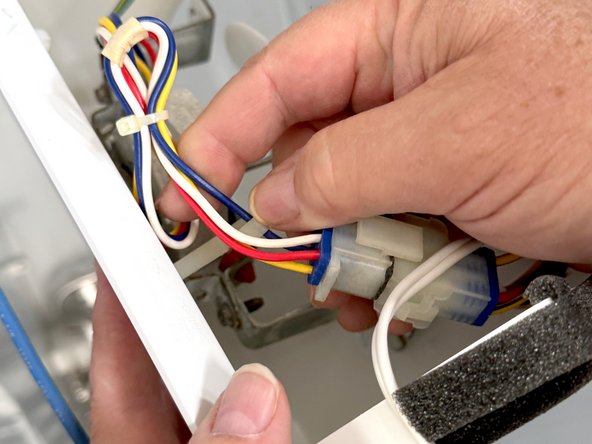

  29. GE Side-By-Side Refrigerator Evaporator Fan Replacement, Disconnect the evaporator fan assembly: 步骤 29 中的图像 1,2 GE Side-By-Side Refrigerator Evaporator Fan Replacement, Disconnect the evaporator fan assembly: 步骤 29 中的图像 2,2
    • Remove the fan wires from the retaining clip on the fan housing.
  30. GE Side-By-Side Refrigerator Evaporator Fan Replacement: 步骤 30 中的图像 1,2 GE Side-By-Side Refrigerator Evaporator Fan Replacement: 步骤 30 中的图像 2,2
    • Squeeze the locking tabs to release the connector, and pull it apart to disconnect the evaporator fan assembly.

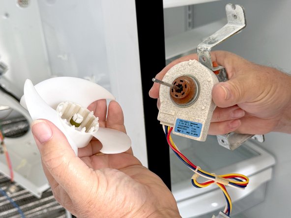

  33. GE Side-By-Side Refrigerator Evaporator Fan Replacement, Remove the evaporator fan blades: 步骤 33 中的图像 1,2 GE Side-By-Side Refrigerator Evaporator Fan Replacement, Remove the evaporator fan blades: 步骤 33 中的图像 2,2
    • Use a pair of pliers as a lever to lift the fan blades and slide them off the shaft of the evaporator fan motor.
    • You can now replace the evaporator fan motor.
