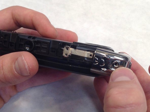

  4. Fujifilm XP20 Rear Case Replacement: 步骤 4 中的图像 1,3 Fujifilm XP20 Rear Case Replacement: 步骤 4 中的图像 2,3 Fujifilm XP20 Rear Case Replacement: 步骤 4 中的图像 3,3
    • Using a 1.5mm Hex screwdriver, remove the 3.0 mm hex screw on top edge of silver panel.
    • Using a Phillips #00 screwdriver, remove the 3.0 mm screw on bottom edge.
    • Once both screws are removed the silver side casing will slide off.

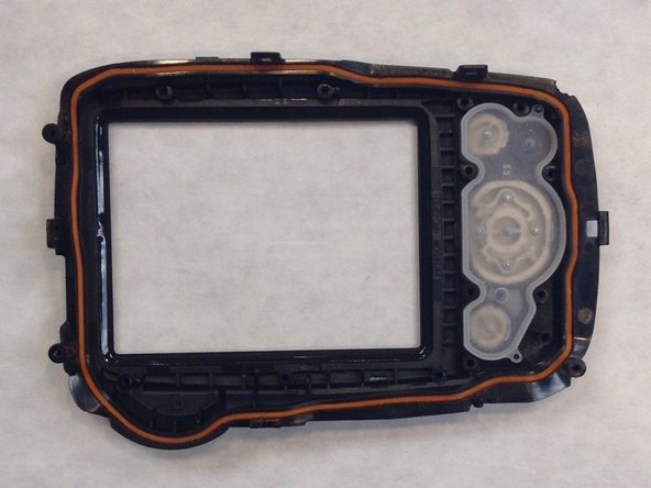

  6. Fujifilm XP20 Rear Case Replacement: 步骤 6 中的图像 1,3 Fujifilm XP20 Rear Case Replacement: 步骤 6 中的图像 2,3 Fujifilm XP20 Rear Case Replacement: 步骤 6 中的图像 3,3
    • Using a Phillips #00 screwdriver, remove the seven 3.0 mm screws.
    • Remove the remaining five 3.0 mm screws which hold the rear case and the control panel together.
    • The rear panel is now free from the camera.
