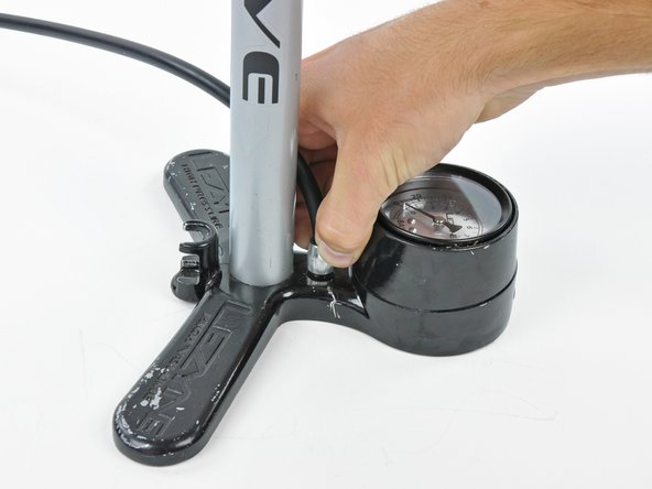

    • Use a pair of pliers to loosen the hose pinch by turning it counterclockwise a couple of turns.
    • Continue to loosen the hose pinch by hand until it comes free from its threads.
    • Slide the hose pinch down the tube so that it does not interfere with removing the hose.
  2. Floor Pump Drive Hose Replacement: 步骤 2 中的图像 1,3 Floor Pump Drive Hose Replacement: 步骤 2 中的图像 2,3 Floor Pump Drive Hose Replacement: 步骤 2 中的图像 3,3
    • Using a hobby knife, carefully slice a slit in the bottom of the hose to allow it to slide off.
    • Be careful and go slowly so as not to damage the nipple underneath.
    • Use a metal prying tool or flathead screwdriver to pry the hose up off of the nipple.
    • Remove the hose from the pump.
  3. Floor Pump Drive Hose Replacement: 步骤 3 中的图像 1,2 Floor Pump Drive Hose Replacement: 步骤 3 中的图像 2,2
    • Slide the hose pinch off of the end of the old hose and onto the new hose.
    • Be sure that the threaded end of the hose pinch faces toward the open end of the new hose.
  4. Floor Pump Drive Hose Replacement: 步骤 4 中的图像 1,3 Floor Pump Drive Hose Replacement: 步骤 4 中的图像 2,3 Floor Pump Drive Hose Replacement: 步骤 4 中的图像 3,3
    • Use a metal rod or screwdriver to widen the new hose so that it will fit over the nipple.
    • Slide the hose in place.
    • Push down on the hose clamp while twisting it clockwise to thread it in place.
