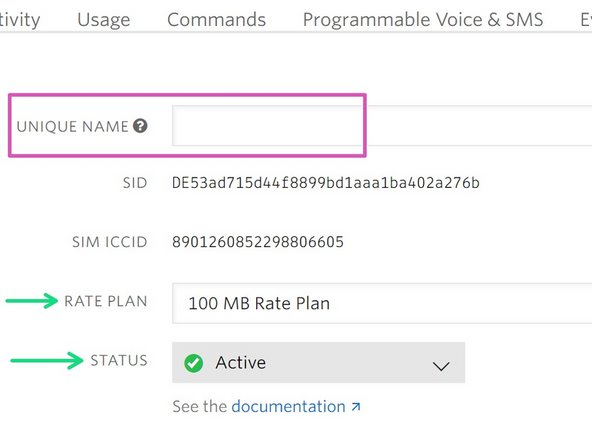

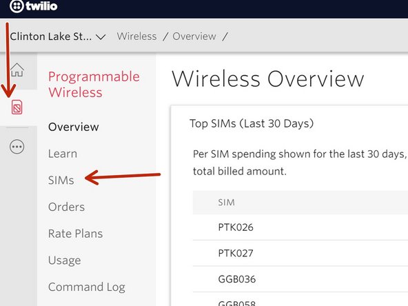

  30. Error-proofing of Depth Sensor Deployments, Important: Cell Network: 步骤 30 中的图像 1,3 Error-proofing of Depth Sensor Deployments, Important: Cell Network: 步骤 30 中的图像 2,3 Error-proofing of Depth Sensor Deployments, Important: Cell Network: 步骤 30 中的图像 3,3
    • In-lab: Make sure the sensors node is connected to the cell network. Ask administators to connect it if it's not.
    • If doing this by yourself then follow the next steps:
    • Step1: Check for "Active" on the Twilio website. Use the MEID to search the SIM repositoy on Twilio. If it's active then you are done.
    • Step 2: If the search on Twilio did not return anything then check the Node has a SIM card. If yes, then check and update the 'SIM-Node ID pairings' spreadsheet here. If the Node does not have one, get a SIM from an admin and fill in the spreadsheet linked above.
    • Step 3: After the node gets a SIM card and the infomation is logged in the 'SIM-Node ID pairings' spreadsheet proceed to activate the SIM card. You will have to log into the Twilio website and activate it. Consult the attached picture to see how the setting should be set.
    • Unique Name = Node ID (i.e PTK001). If the Node ID is already taken then doulbe check the ID parings here. If it's all good, then edit all the Twilio unique names accordingly.

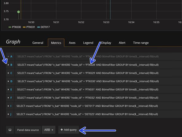

  35. Error-proofing of Depth Sensor Deployments, In-lab: Set up a Grafana Dashboard: 步骤 35 中的图像 1,3 Error-proofing of Depth Sensor Deployments, In-lab: Set up a Grafana Dashboard: 步骤 35 中的图像 2,3 Error-proofing of Depth Sensor Deployments, In-lab: Set up a Grafana Dashboard: 步骤 35 中的图像 3,3
    • Assumption: you have the Grafana credentials.
    • Use an existing Dashboard (i.e. Abhis Hostage Nodes) or create one.
    • To enter the edit panel click the header and it will appear. If you created a new dashboard, then you must create a 'v_bat' panel and a 'maxbotix_depth' panel. They should be labeled to indicate battery voltage and depth. Always save changes frequently.
    • Once inside the edit panel: It's possible to edit an already existing entry and only update the Node ID and alias. Alternatively can click on 'add query'. When adding a new query get an admin to supervise while you do it.
    • Use this dashboard exclusively for testing and delete already deployed nodes. Sensors that have been deployed should be promoted to their permanent Grafana Dashboard. i.e: Cinton River, Huron River,...

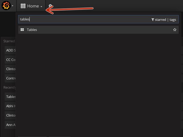

  36. Error-proofing of Depth Sensor Deployments, In-lab step: Observe the readings: 步骤 36 中的图像 1,2 Error-proofing of Depth Sensor Deployments, In-lab step: Observe the readings: 步骤 36 中的图像 2,2
    • Click on the nodes INDIVIDUALLY to see that the reported values are sensible. If the depth reading is -1 then there is an ultrasonic sensor problem. If the depth value is 0, then the ultrasonic sensor does not have 0.5 meters of required space between itself and what it's reading.
