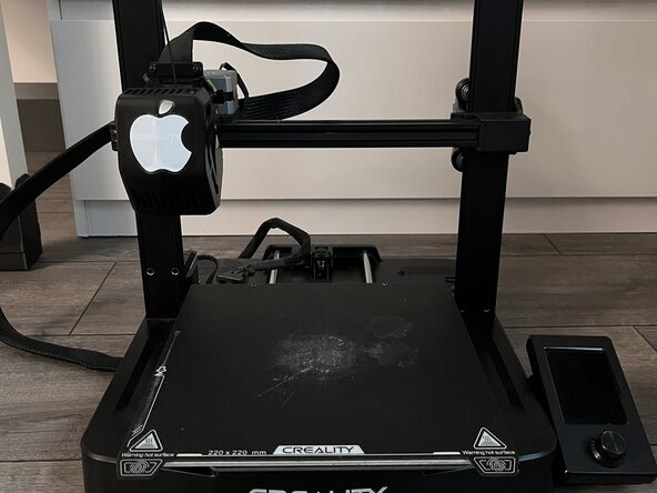

    • Make sure to disconnect the printer from power
    • Move the tool head up to make space over the hot bed (Push up on the gantry, not the tool head itself

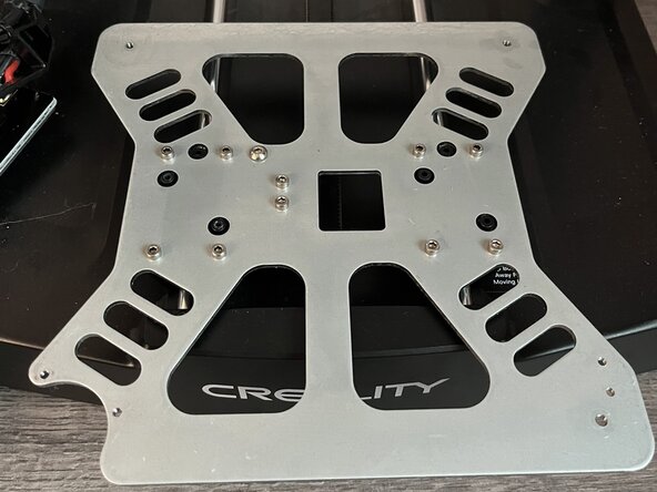

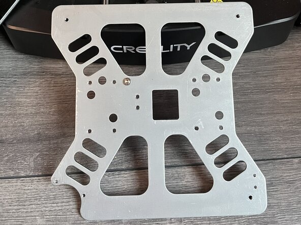

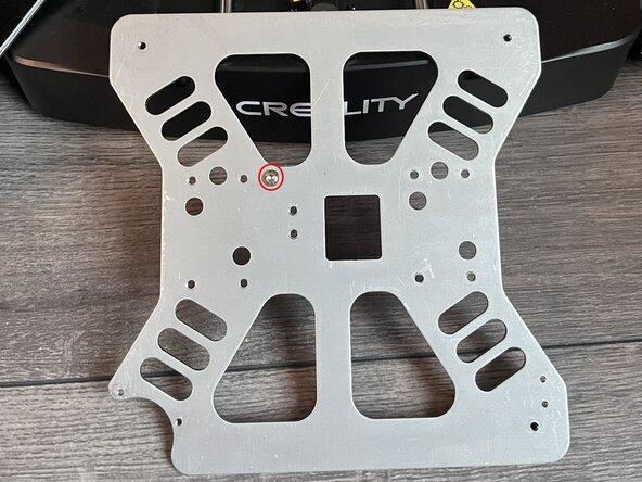

  5. Ender 3 V3 SE Hot Bed Replacement, Removing the metal bracket: 步骤 5 中的图像 1,2 Ender 3 V3 SE Hot Bed Replacement, Removing the metal bracket: 步骤 5 中的图像 2,2
    • Remove the 10 silver screws shown to remove the metal bracket
    • Lift the bracket off the bearings
