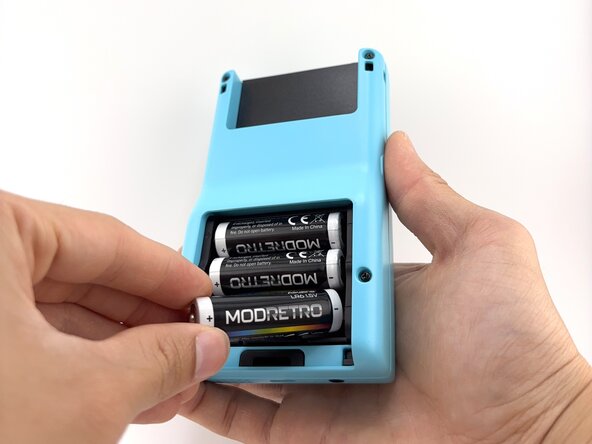

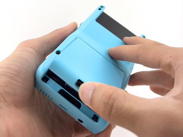

  1. Disassembling ModRetro Chromatic (Released Mid-2025), Battery Cover and Batteries: 步骤 1 中的图像 1,3 Disassembling ModRetro Chromatic (Released Mid-2025), Battery Cover and Batteries: 步骤 1 中的图像 2,3 Disassembling ModRetro Chromatic (Released Mid-2025), Battery Cover and Batteries: 步骤 1 中的图像 3,3
    • To remove the battery cover, push upward on the battery cover lock. The battery cover will pop open.
    • Lift the battery cover off and set aside.
    • Remove the batteries.
    • Always remove the batteries before working on your Chromatic!

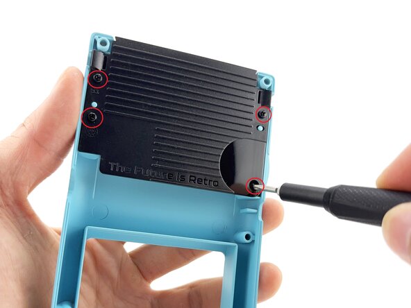

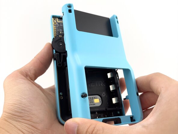

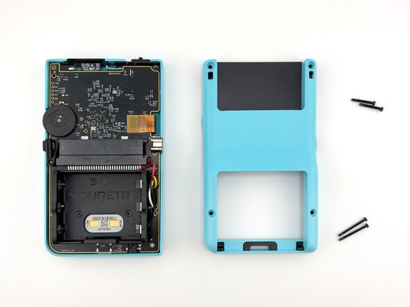

  2. Disassembling ModRetro Chromatic (Released Mid-2025), Back Shell: 步骤 2 中的图像 1,3 Disassembling ModRetro Chromatic (Released Mid-2025), Back Shell: 步骤 2 中的图像 2,3 Disassembling ModRetro Chromatic (Released Mid-2025), Back Shell: 步骤 2 中的图像 3,3
    • Remove the back shell screws (x4) using a Tri-wing Y1 Screwdriver.
    • A Tri-wing Y1.5 will also work for all screws.
    • The screws near the top are a different length than the screws near the bottom of the shell.
    • Remove the back shell by lifting away from the device.

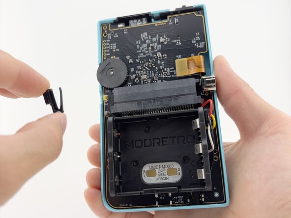

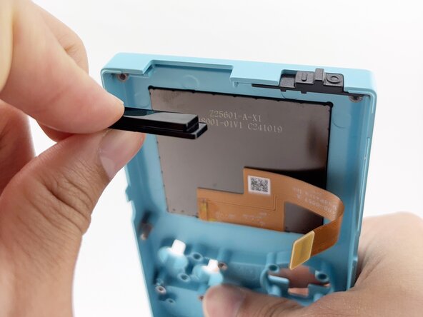

  3. Disassembling ModRetro Chromatic (Released Mid-2025), Menu Button: 步骤 3 中的图像 1,3 Disassembling ModRetro Chromatic (Released Mid-2025), Menu Button: 步骤 3 中的图像 2,3 Disassembling ModRetro Chromatic (Released Mid-2025), Menu Button: 步骤 3 中的图像 3,3
    • Remove the menu button by lifting it off the post. It will remove with little to no resistance.

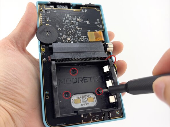

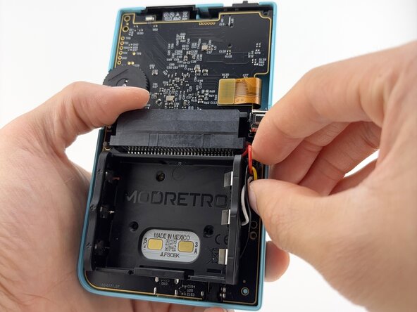

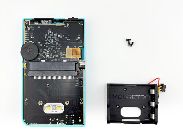

  4. Disassembling ModRetro Chromatic (Released Mid-2025), Battery Tray: 步骤 4 中的图像 1,3 Disassembling ModRetro Chromatic (Released Mid-2025), Battery Tray: 步骤 4 中的图像 2,3 Disassembling ModRetro Chromatic (Released Mid-2025), Battery Tray: 步骤 4 中的图像 3,3
    • Remove the battery tray screws (x3) using a Tri-wing Y1 Screwdriver.
    • Remove the battery tray connector.
    • It is helpful to press lightly against the PCB with your off hand while working the connector loose.

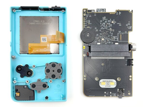

  5. Disassembling ModRetro Chromatic (Released Mid-2025), PCB: 步骤 5 中的图像 1,2 Disassembling ModRetro Chromatic (Released Mid-2025), PCB: 步骤 5 中的图像 2,2
    • Carefully lift the LCD screen ribbon cable from the PCB.
    • Handle with care!
    • Carefully remove the PCB from the front shell.
    • Lifting at a slight angle will help clear the headphone jack on the bottom more easily. This is also important during re-assembly.

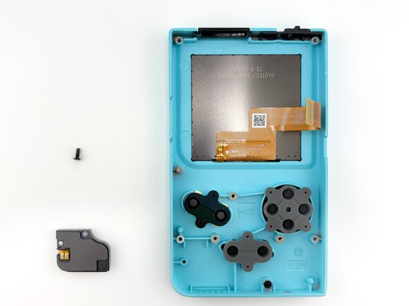

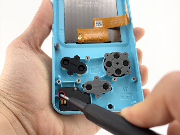

  6. Disassembling ModRetro Chromatic (Released Mid-2025), Speaker Module: 步骤 6 中的图像 1,3 Disassembling ModRetro Chromatic (Released Mid-2025), Speaker Module: 步骤 6 中的图像 2,3 Disassembling ModRetro Chromatic (Released Mid-2025), Speaker Module: 步骤 6 中的图像 3,3
    • Remove the speaker module screw (x1) using a Tri-wing Y1 Screwdriver.
    • Carefully remove the speaker module from the front shell.

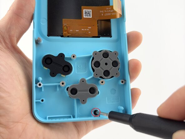

  7. Disassembling ModRetro Chromatic (Released Mid-2025), Light Pipe: 步骤 7 中的图像 1,2 Disassembling ModRetro Chromatic (Released Mid-2025), Light Pipe: 步骤 7 中的图像 2,2
    • Remove the light pipe screw (x1) using a Tri-wing Y1 Screwdriver.
    询问修复机器人

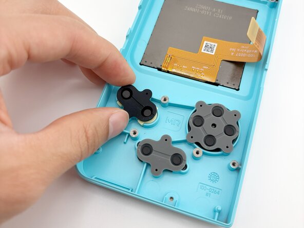

  8. Disassembling ModRetro Chromatic (Released Mid-2025), Buttons and Membranes: 步骤 8 中的图像 1,3 Disassembling ModRetro Chromatic (Released Mid-2025), Buttons and Membranes: 步骤 8 中的图像 2,3 Disassembling ModRetro Chromatic (Released Mid-2025), Buttons and Membranes: 步骤 8 中的图像 3,3
    • Remove the rubber button membranes (x3) from their pockets.
    • Remove the buttons and the D-pad from the shell with tweezers or by hand. If you flip the shell over, they will fall out freely.
    • The buttons will come out easily once the membranes are removed.
    • When re-attaching the rubber button membranes, be sure the positive features on the membranes seat securely into the pockets on the shell.

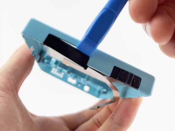

  9. Disassembling ModRetro Chromatic (Released Mid-2025), IR Window: 步骤 9 中的图像 1,3 Disassembling ModRetro Chromatic (Released Mid-2025), IR Window: 步骤 9 中的图像 2,3 Disassembling ModRetro Chromatic (Released Mid-2025), IR Window: 步骤 9 中的图像 3,3
    • Carefully separate the IR window by gently wedging a plastic spudger between the IR window and the front shell.
    • Re-installing the IR window:
    • Note the side with the lip is inserted towards the front shell first.
    • Press in firmly until fully seated against the shell.
    • If the IR window fits loosely, the orientation is incorrect. The fit should be snug.

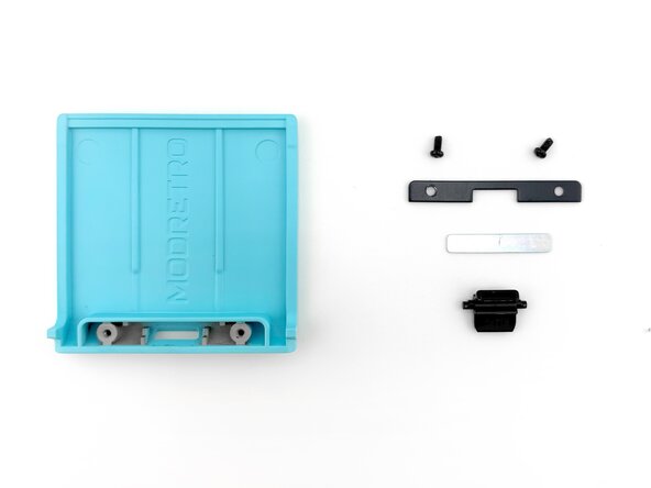

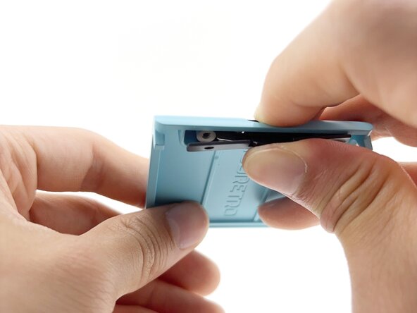

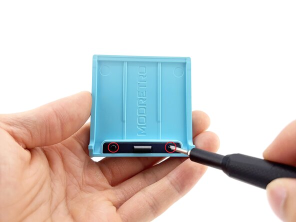

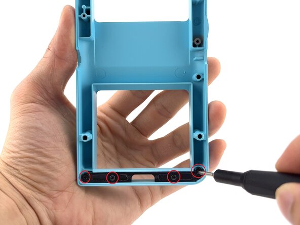

  13. Disassembling ModRetro Chromatic (Released Mid-2025), Battery Cover: 步骤 13 中的图像 1,3 Disassembling ModRetro Chromatic (Released Mid-2025), Battery Cover: 步骤 13 中的图像 2,3 Disassembling ModRetro Chromatic (Released Mid-2025), Battery Cover: 步骤 13 中的图像 3,3
    • Remove the screws (x2) securing the latch cover using a Tri-wing Y1 Screwdriver.
    • Remove the door plate spring by fully depressing the battery cover lock. The spring should pop out.
    • Use a spudger if the spring does not fully dislodge.
    • Once the spring is removed, the battery cover lock can be removed without resistance through the underside of the battery cover.
