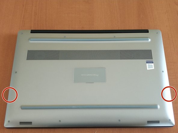

  2. Dell Precision 5540 Fans Replacement, Remove the base cover: 步骤 3 中的图像 1,2 Dell Precision 5540 Fans Replacement, Remove the base cover: 步骤 3 中的图像 2,2
    • Pry the edges of the base cover and lift it to remove it from the computer. Consider using a spudger.
    • Two case latches are approximately here.
