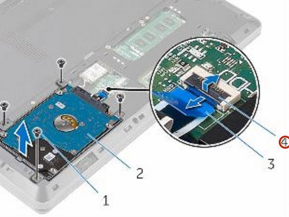

  1. Dell Inspiron 14 3459 Hard Drive Replacement, Remove the Screws: 步骤 1 中的图像 1,1
    • WARNING: Before working inside your computer, read the safety information that shipped with your computer and follow the steps in Before Working Inside Your Computer. After working inside your computer, follow the instructions in After Working Inside Your Computer.
    • CAUTION: Hard drives are fragile. Exercise care when handling the hard drive.
    • Remove the screws that secure the hard-drive assembly to the computer base.
  2. Dell Inspiron 14 3459 Hard Drive Replacement, Disconnect the Hard Drive Cable: 步骤 2 中的图像 1,2 Dell Inspiron 14 3459 Hard Drive Replacement, Disconnect the Hard Drive Cable: 步骤 2 中的图像 2,2
    • Open the latch and disconnect the hard-drive cable from the system board.
  3. Dell Inspiron 14 3459 Hard Drive Replacement, Lifting the Hard-Drive Assembly: 步骤 3 中的图像 1,1
    • Lift the hard-drive assembly off the computer base.
