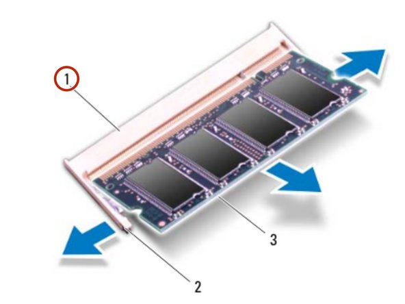

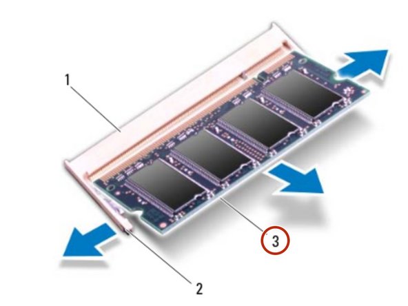

  2. Dell Alienware M17x R4 Memory Modules Replacement, Popping Up the Memory Module: 步骤 2 中的图像 1,1
    • CAUTION: To prevent damage to the memory-module connector, do not use tools to spread the memory module securing clips.
    • Use your fingertips to carefully spread apart the securing clips on each end of the memory-module connector until the memory module pops up.
  3. Dell Alienware M17x R4 Memory Modules Replacement, Removing the Memory Module: 步骤 3 中的图像 1,2 Dell Alienware M17x R4 Memory Modules Replacement, Removing the Memory Module: 步骤 3 中的图像 2,2
    • Remove the memory module from the memory-module connector.
