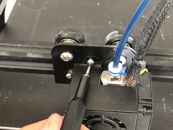

  5. Creality Ender 3 Pro Hotend Replacement, Hotend: 步骤 5 中的图像 1,3 Creality Ender 3 Pro Hotend Replacement, Hotend: 步骤 5 中的图像 2,3 Creality Ender 3 Pro Hotend Replacement, Hotend: 步骤 5 中的图像 3,3
    • Remove the two screws from the fan housing using the 2 mm hex key.
    • Pull the housing away from the hotend assembly and set the screws aside.

    • Remove the two large screws from the heatsink of the hotend using the 2mm hex key.
    • Pull the hotend away from the gantry.
