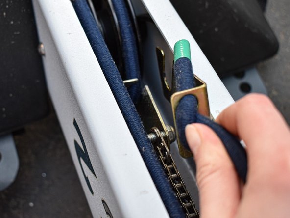

    • Unhook the S.C.A.M. clip from the axel at the end of the rower near the foot straps. This clip is attached to the pulley that runs through the body of the machine.

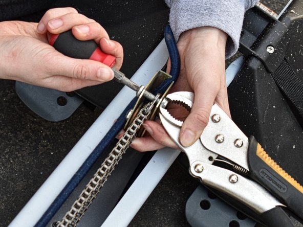

  4. Concept2 Rowing Machine Chain Replacement: 步骤 4 中的图像 1,2 Concept2 Rowing Machine Chain Replacement: 步骤 4 中的图像 2,2
    • Using an adjustable wrench and Phillips #00 screwdriver, unscrew the top 31.75 mm (1-1/4") Phillips pan head screw from the metal component at the end of your machine near the foot straps.

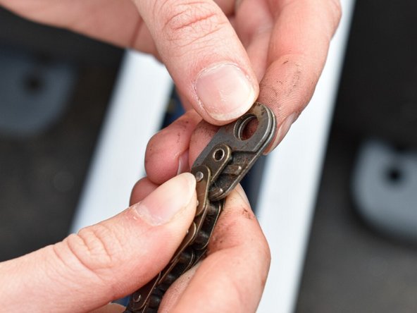

  5. Concept2 Rowing Machine Chain Replacement: 步骤 5 中的图像 1,3 Concept2 Rowing Machine Chain Replacement: 步骤 5 中的图像 2,3 Concept2 Rowing Machine Chain Replacement: 步骤 5 中的图像 3,3
    • Remove the two opposing clips from the end of the chain.
    • Note the orientation of these clips for reassembly later on.

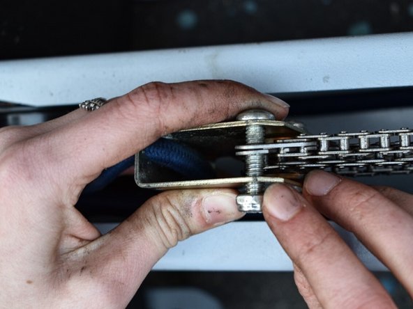

  8. Concept2 Rowing Machine Chain Replacement: 步骤 8 中的图像 1,1
    • Slide the U-bolt through the end of the new chain and reattach to the handle using an adjustable wrench.

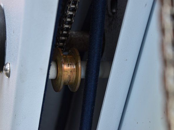

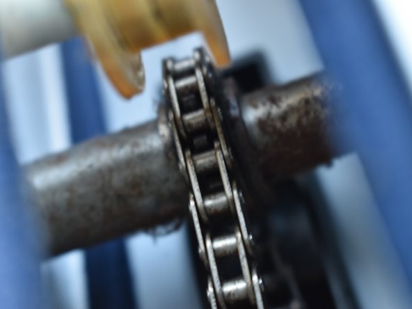

  9. Concept2 Rowing Machine Chain Replacement: 步骤 9 中的图像 1,3 Concept2 Rowing Machine Chain Replacement: 步骤 9 中的图像 2,3 Concept2 Rowing Machine Chain Replacement: 步骤 9 中的图像 3,3
    • Begin to guide the end of the chain opposite the handle back through the rowing machine.
    • Make sure to properly line up the chain with any gears or pulleys inside the machine. These images illustrate key points where the chain should be placed.
