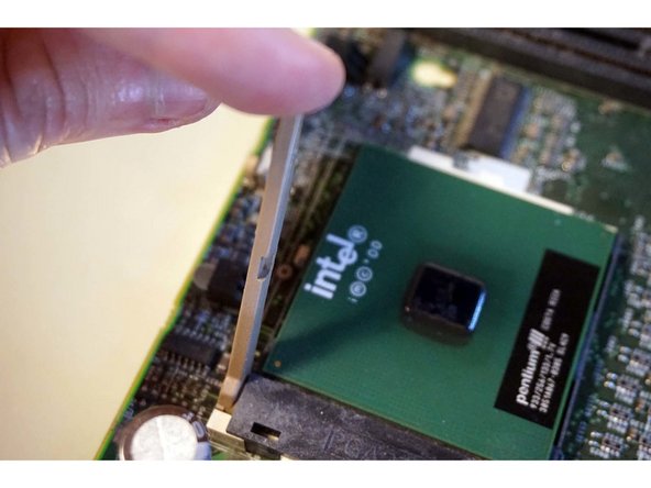

  15. Compaq Deskpro EN Teardown: 步骤 15 中的图像 1,3 Compaq Deskpro EN Teardown: 步骤 15 中的图像 2,3 Compaq Deskpro EN Teardown: 步骤 15 中的图像 3,3

    • Removing the CPU requires a steady hand and can be slightly intimidating.
    • A beige lever keeps the CPU locked in place. Pull it away from the processor and then up. The processor will move towards the group of capacitors when it is unlocked.
    • Now would be a good time to ground yourself if you haven't been wearing your nifty anti-static wrist strap.
    • The processor can be removed from the socket by gripping the edges and pulling straight up.
    • DO NOT force or twist the processor from the socket. Consider using a spudger to lift the edges if you can't get a good grip.
    • This is a socket 370 Pentium III "Coppermine" processor clocked at 933 MHz. The other markings indicate 256 KB of L2 cache and a bus speed of 133 MHz.
