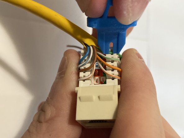

    • Using a punch down tool, force each individual wire deep into the base of the appropriate slots on the RJ-45 Keystone Jack.
    • When using a metal punch down tool, make sure to have the long edge of the tool on the exterior of the RJ-45 Keystone Jack. This part of metal punch down tools act as a cutting function to automatically remove excess wiring.
  8. Cat5e RJ-45 Keystone Jack Replacement: 步骤 8 中的图像 1,2 Cat5e RJ-45 Keystone Jack Replacement: 步骤 8 中的图像 2,2
    • Once each wire is placed into the correct slots, use your punch down tool a second time in order to ensure that each wire is connected securely to the RJ-45 Keystone Jack.
