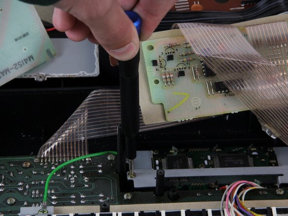

  2. Casio CZ-1000 Display Screen Replacement: 步骤 2 中的图像 1,3 Casio CZ-1000 Display Screen Replacement: 步骤 2 中的图像 2,3 Casio CZ-1000 Display Screen Replacement: 步骤 2 中的图像 3,3
    • Using a Phillips #1 screwdriver, remove all 14 5.5 mm screws from the two motherboards.
    • These screws secure the motherboards to the keyboard assembly and the dial on the right side.
