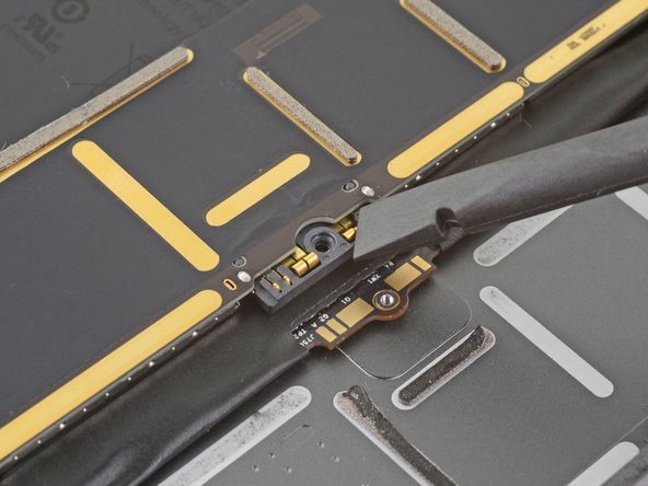

  4. Battery Blocking, Battery connector information: 步骤 4 中的图像 1,3 Battery Blocking, Battery connector information: 步骤 4 中的图像 2,3 Battery Blocking, Battery connector information: 步骤 4 中的图像 3,3
    • These photos show what the battery connector looks like underneath the logic board. Use these photos as a reference while you safely disconnect the battery.
    • Notice that the battery connector has cantilever springs on the logic board that press against the battery contact pads. Since both the logic board and battery are glued down, you'll need to slide something thin and flexible between the contact points to disconnect the battery.

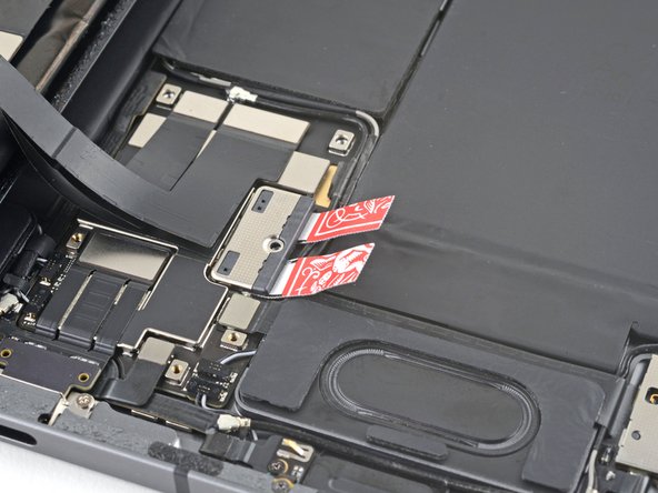

  5. Battery Blocking, Create a battery blocker: 步骤 5 中的图像 1,3 Battery Blocking, Create a battery blocker: 步骤 5 中的图像 2,3 Battery Blocking, Create a battery blocker: 步骤 5 中的图像 3,3
    • Cut two 6 mm wide strips from a playing card or cardstock to use as a battery blocker.
    • The strips should be about 4 cm long so you can easily grip them.
  6. Battery Blocking, Insert the card strips: 步骤 6 中的图像 1,3 Battery Blocking, Insert the card strips: 步骤 6 中的图像 2,3 Battery Blocking, Insert the card strips: 步骤 6 中的图像 3,3
    • Insert the card strips on each side of the battery connector until they stop.
