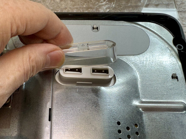

  5. Apple Studio Display M2454 Teardown: 步骤 5 中的图像 1,2 Apple Studio Display M2454 Teardown: 步骤 5 中的图像 2,2
    • To remove the metal panel, push towards the bottom of the monitor to release its clips and pull the panel away. (You will need to remove the transparent plastic piece on the two USB ports first.)
    询问修复机器人
    添加评论
