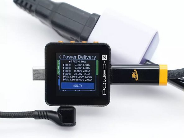

  6. ANKER Mini 30W GaN PD Charger A2147 Teardown, charging protocol: 步骤 6 中的图像 1,2 ANKER Mini 30W GaN PD Charger A2147 Teardown, charging protocol: 步骤 6 中的图像 2,2
    • Using ChargerLAB POWER-Z KM002C, the charger supports FCP, AFC, PD3.0, PPS, QC4 charging protocols.
    • In addition, it also has four sets of fixed voltage gears of 5V3A, 9V3A, 15V2A, and 20V1.5A, and two sets of PPS voltage gears of 3.3-11V3A and 3.3-16V2A.

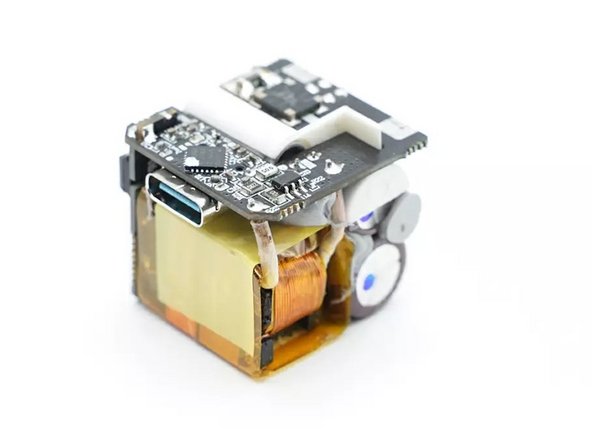

  8. ANKER Mini 30W GaN PD Charger A2147 Teardown, Internal display1: 步骤 9 中的图像 1,3 ANKER Mini 30W GaN PD Charger A2147 Teardown, Internal display1: 步骤 9 中的图像 2,3 ANKER Mini 30W GaN PD Charger A2147 Teardown, Internal display1: 步骤 9 中的图像 3,3
    • The PCBA module is composed of two PCBs welded together.
    • The bottom board is welded with the rectifier bridge, synchronous rectification circuit and protocol chip, and the primary and secondary stages are isolated and insulated with white plastic brackets.
    • The small side board is welded with gallium nitride packaged chips, transformers and high-voltage filter capacitors to make full use of the space.
    询问修复机器人
    添加评论
  9. ANKER Mini 30W GaN PD Charger A2147 Teardown, Internal display 2: 步骤 10 中的图像 1,3 ANKER Mini 30W GaN PD Charger A2147 Teardown, Internal display 2: 步骤 10 中的图像 2,3 ANKER Mini 30W GaN PD Charger A2147 Teardown, Internal display 2: 步骤 10 中的图像 3,3
    • The space between the two PCBs is soldered with high-voltage filter capacitors and transformers.
    • Separate the two small boards by welding, and use a white plastic insulator between the small boards for isolation between the primary electrolytic capacitor and the output solid capacitor.
    • Through the observation of the charger PCBA module, it is found that Anke's 30W GaN charger adopts a high-frequency QR switching power supply design, uses Nanxin Technology to seal the GaN chip and synchronous rectification controller, and the output voltage is passed by the protocol chip. Optocoupler control.
    • Next, we will start to understand the design and materials of the entire charger from the input end.
    • Front view of the small board at the bottom, welding fuse, common mode inductor, synchronous rectifier, VBUS switch tube and USB-C socket. The output filter capacitor is welded by sinking plate to reduce the thickness.

  10. ANKER Mini 30W GaN PD Charger A2147 Teardown, Internal display 3: 步骤 11 中的图像 1,3 ANKER Mini 30W GaN PD Charger A2147 Teardown, Internal display 3: 步骤 11 中的图像 2,3 ANKER Mini 30W GaN PD Charger A2147 Teardown, Internal display 3: 步骤 11 中的图像 3,3
    • The rectifier bridge, protocol chip and synchronous rectification controller are welded on the back of the small board.
    • The time-delay fuse at the input end comes from Beite Electronics, and its specification is 2A 250V.
    • The common mode inductor is wound with enameled wire and insulated wire, and wrapped with high temperature tape for insulation.

  11. ANKER Mini 30W GaN PD Charger A2147 Teardown, Internal display 4: 步骤 12 中的图像 1,3 ANKER Mini 30W GaN PD Charger A2147 Teardown, Internal display 4: 步骤 12 中的图像 2,3 ANKER Mini 30W GaN PD Charger A2147 Teardown, Internal display 4: 步骤 12 中的图像 3,3
    • The rectifier bridge comes from ZOWIE Zhiwei, model Z4RGP30MP, it is a fast recovery rectifier bridge, the specification is 1000V 3A, it adopts SMD package.
    • The pulsating direct current output by the rectifier bridge is connected to the small side board, and is filtered by an electrolytic capacitor to supply power to the GaN packaged chip.
    • The front side of the small side board is welded with differential mode inductors, filter electrolytic capacitors and transformers.

  13. ANKER Mini 30W GaN PD Charger A2147 Teardown, Internal display 5: 步骤 14 中的图像 1,3 ANKER Mini 30W GaN PD Charger A2147 Teardown, Internal display 5: 步骤 14 中的图像 2,3 ANKER Mini 30W GaN PD Charger A2147 Teardown, Internal display 5: 步骤 14 中的图像 3,3
    • The main control chip of switching power supply adopts SC3056 of Nanxin Technology, which has built-in gallium nitride power device and controller.
    • A 300mΩ resistor is used to sense the primary current.
    • The transformer adopts EE15 skeleton, the magnetic core is wrapped with copper foil for shielding, and the outer layer is wrapped with high-temperature tape for insulation.

  14. ANKER Mini 30W GaN PD Charger A2147 Teardown, Internal display 6: 步骤 15 中的图像 1,3 ANKER Mini 30W GaN PD Charger A2147 Teardown, Internal display 6: 步骤 15 中的图像 2,3 ANKER Mini 30W GaN PD Charger A2147 Teardown, Internal display 6: 步骤 15 中的图像 3,3
    • SMD Y capacitors are from Anshan Qifa.
    • SMD optocoupler is used for output voltage feedback regulation.
    • The synchronous rectification controller comes from Nanxin Technology, model SC3503, which is an adaptive turn-on detection and fast turn-off synchronous rectification controller.

  15. ANKER Mini 30W GaN PD Charger A2147 Teardown, Internal display 7: 步骤 16 中的图像 1,3 ANKER Mini 30W GaN PD Charger A2147 Teardown, Internal display 7: 步骤 16 中的图像 2,3 ANKER Mini 30W GaN PD Charger A2147 Teardown, Internal display 7: 步骤 16 中的图像 3,3
    • Synchronous rectification MOS tube screen printing 66940, from AOS Bandai.
    • The output filter capacitor is from YMIN, NPX series solid capacitor, the specification is 470μF 25V.
    • The USB PD fast charging protocol chip adopts Infineon CYPD3174, which supports PD3.0 including PPS protocol, QC4.0, Apple 2.4A and other fast charging protocols; built-in multiple comprehensive protection functions, built-in 32-bit M0 processor, Integrated oscillator and no external clock required.
    • Weld an NTC thermistor on the left side of CYPD3174 to detect the internal temperature of the USB-C socket and the charger to realize the live protection function.
