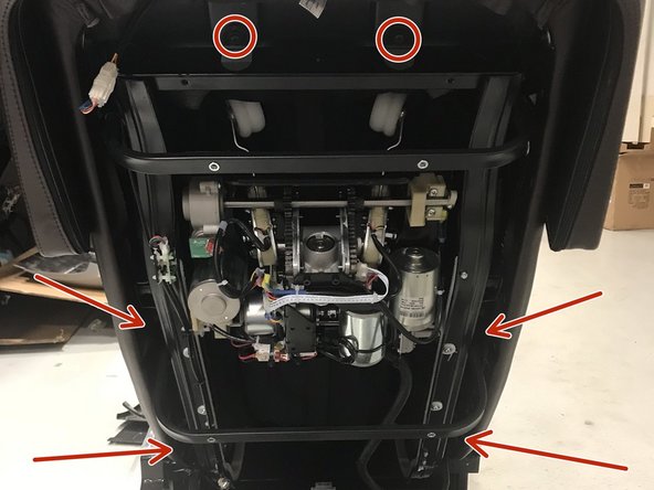

    • Remove all 6 screws on frame. 2 up top and 2 on both sides.

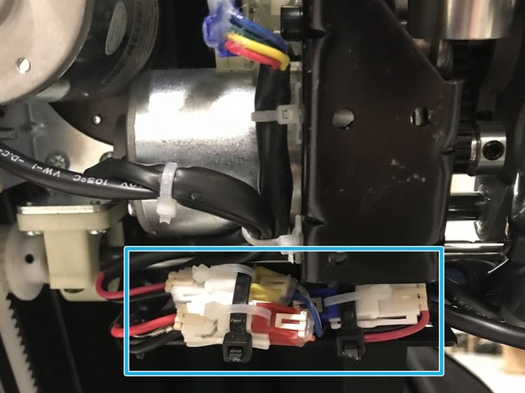

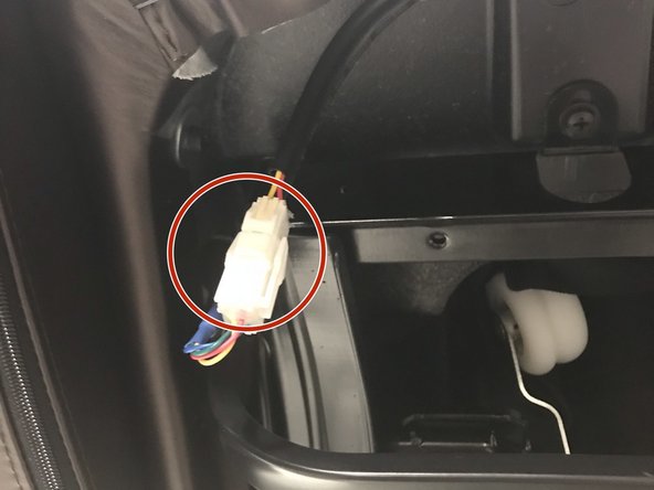

    • The mechanism has a wire harness that runs down to the main PCB in the chair. Most of our 3D mechs come with a new harness pre-attached and the old harness will need to be disconnected from the quick disconnect .
    • Don't disconnect these if your new mechanism has them pre-attached.
    • This is an extremely vague photo , but the quick disconnect is located in the sheath on the lower left hand side of the chair . DON"T CUT THE SHEATHING JUST THE ZIP TIES . If you cant get this zip tied onto the frame like the factory had it no worries just make sure its secured in the general location with zip ties .
    • WHEN RE RUNNING THIS HARNESS BE SURE YOU ARE TAKING NOTE OF THE ORIGINAL ZIP TIE LOCATIONS .
  8. 3D Mechanism Replacement, Wire harness: 步骤 8 中的图像 1,3 3D Mechanism Replacement, Wire harness: 步骤 8 中的图像 2,3 3D Mechanism Replacement, Wire harness: 步骤 8 中的图像 3,3
    • This is the entire upper harness that connects to the 3D mechanism .
    • Lower harness that connects to main PCB . see last step for location
    • Quick disconnect . located on frame .

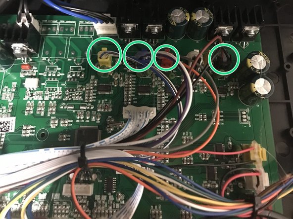

    • Remove the 3 screws on the lower power box cover to gain access to the lower wire harness
    • unscrew the wire harness clip by removing the 2 screws
    • These marked connectors are the motor wires and these are not all of the wires on this harness. please see last step

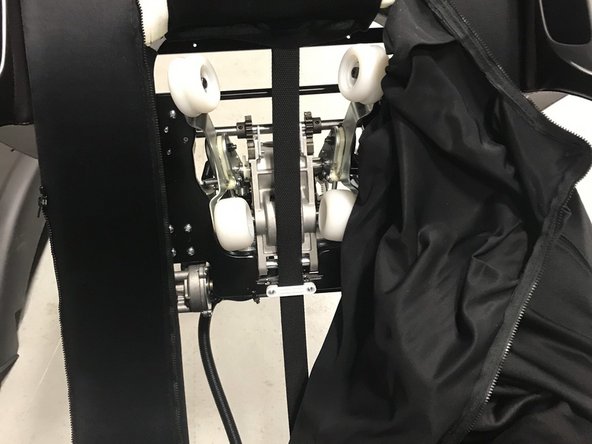

    • The new mech will not come with the plastic wheels , these will need to be transferred from the old mech to the new one. see photo for location of wheels.

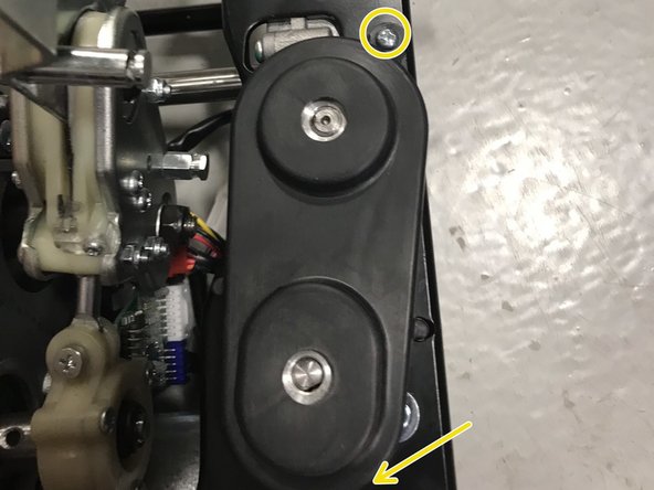

    • If for some reason you cant get the mechanism into the chair due to the top axle blocking it . Its due to this 3D gear not being set at the correct angle.
    • To fix the angle simply remove this cover by removing the 2 screws and spin the motor belt until angle is correct.
