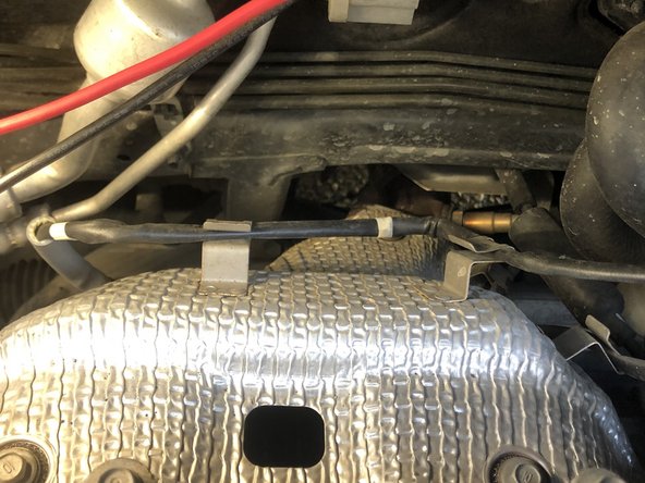

    • Locate the sensor off the exhaust header and follow the wire up to the connector.
    • Some of the pieces on the top-front of the engine are sharp; be careful what you lean on.
    • Gently work the connector out of the bracket, then disconnect it by pressing the tab inward then pulling out.
    • Plastic gets brittle over time. Be gentle and go slow. If it's not coming out, take a break and come back a little later. Be patient to avoid damage.

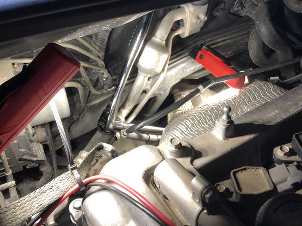

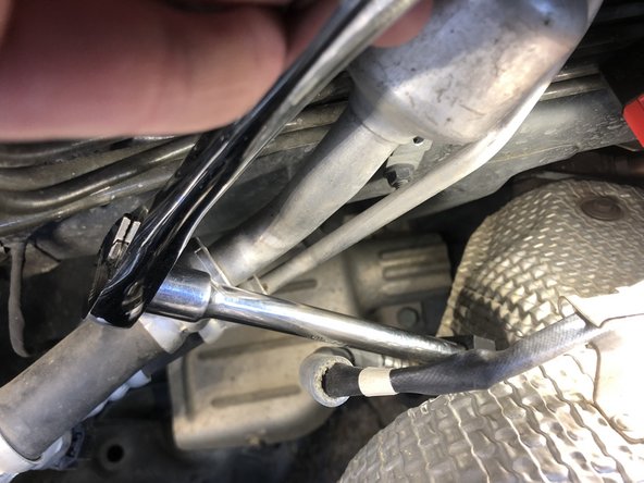

    • Place the 7/8" (22 mm) socket around the O2 sensor. Use a ratchet and 6" extension to loosen and remove the sensor.
    • Place the socket on the sensor without the ratchet in the way. Once the socket is in place, reattach the ratchet and loosen.
    • The sensor is behind the exhaust, up against the firewall. Having a headlamp, or a friend who can hold a flashlight, is a big help. The red lights in these photos are cheap magnetic lights!
