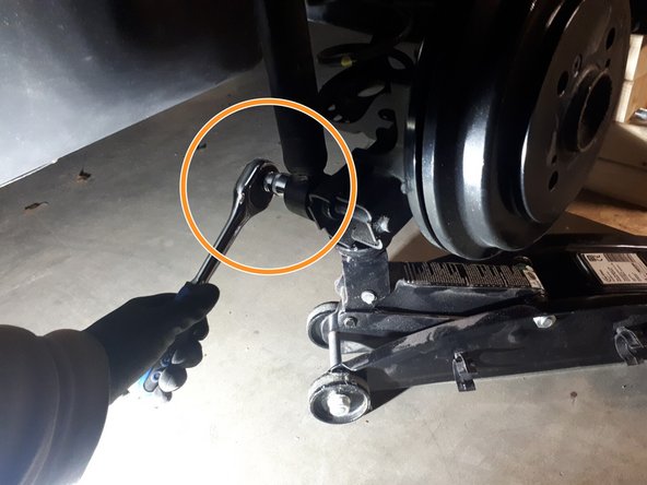

Put the jack under the wheel arm and let the jack bear the weight of the arm but not lift the arm.
Using the 17mm socket, unscrew the nut attaching the bottom of the shock absorber to the wheel arm.
Push the shock absorber towards the car to slide the bottom from the bolt.
Drop the jack holding the wheel arm to unload the spring.
