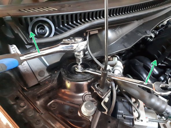

    5. 2010-2017 Suzuki Swift Front Springs Replacement, remove strut assembly: 步骤 6 中的图像 1,3 2010-2017 Suzuki Swift Front Springs Replacement, remove strut assembly: 步骤 6 中的图像 2,3 2010-2017 Suzuki Swift Front Springs Replacement, remove strut assembly: 步骤 6 中的图像 3,3
      • Lower the jack and pull the wheel arm from the bottom strut assembly.
      • Open the hood and remove the plastic cap protecting the upper strut mount.
      • Use the 6mm hex to hold the bolt in place, while loosing the nut with the 17mm wrench. When freeing the nut, hold the strut assembly to prevent it from falling.
      • Remove the strut assembly from the wheel-well while ensuring the cables are not damaged.
