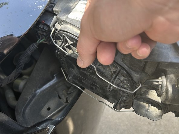

Open the hood of the car and locate the silver locking pin.
Gently grasp the top of the pin and pull it directly up until it is completely removed from the engine bay.
