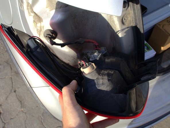

    5. 2008 Suzuki SX4 Brake Light Replacement: 步骤 5 中的图像 1,3 2008 Suzuki SX4 Brake Light Replacement: 步骤 5 中的图像 2,3 2008 Suzuki SX4 Brake Light Replacement: 步骤 5 中的图像 3,3
      • The bulbs can reach high temperatures during operation. Do not handle the bulbs if your vehicle has been in use recently!
      • Twist each bulb-connector to the left to unfasten the bulb from the housing.
      • Repeat this step for each bulb so that you can fully remove the housing.
      • This will give you better access to each bulb.

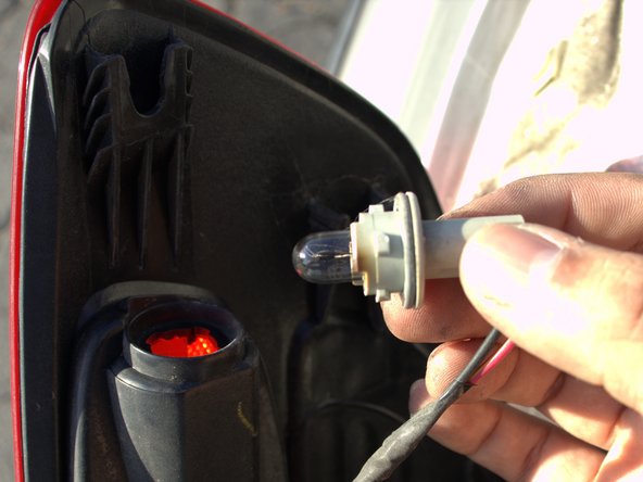

    6. 2008 Suzuki SX4 Brake Light Replacement: 步骤 6 中的图像 1,3 2008 Suzuki SX4 Brake Light Replacement: 步骤 6 中的图像 2,3 2008 Suzuki SX4 Brake Light Replacement: 步骤 6 中的图像 3,3
      • The brake light bulb has a nougat-colored connector.
      • Remove the brake light bulb from its connector by pulling it out of the socket.
      • Do not put too much pressure on the bulb with your hands. It is fragile and can shatter easily.
