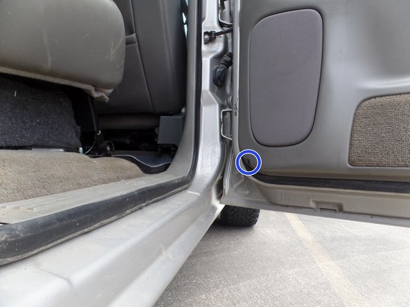

    2. 2005 GMC Sierra SLT 1500 Rear Passenger Side Window Motor Replacement, Unbolting the Door Panel: 步骤 2 中的图像 1,2 2005 GMC Sierra SLT 1500 Rear Passenger Side Window Motor Replacement, Unbolting the Door Panel: 步骤 2 中的图像 2,2
      • Remove the (2) 7mm bolts from the door panel.
      • One is at the bottom left of the door panel and another is behind the arm rest.

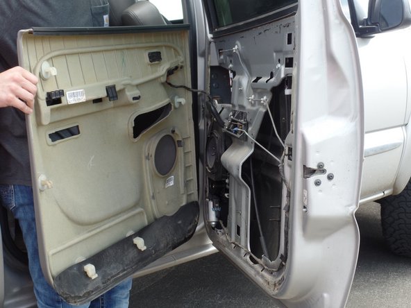

    3. 2005 GMC Sierra SLT 1500 Rear Passenger Side Window Motor Replacement, Separating the Door Panel from the Door: 步骤 3 中的图像 1,3 2005 GMC Sierra SLT 1500 Rear Passenger Side Window Motor Replacement, Separating the Door Panel from the Door: 步骤 3 中的图像 2,3 2005 GMC Sierra SLT 1500 Rear Passenger Side Window Motor Replacement, Separating the Door Panel from the Door: 步骤 3 中的图像 3,3
      • After grabbing the armrest and the bottom of the door panel, pull straight up to separate the door panel from the door.

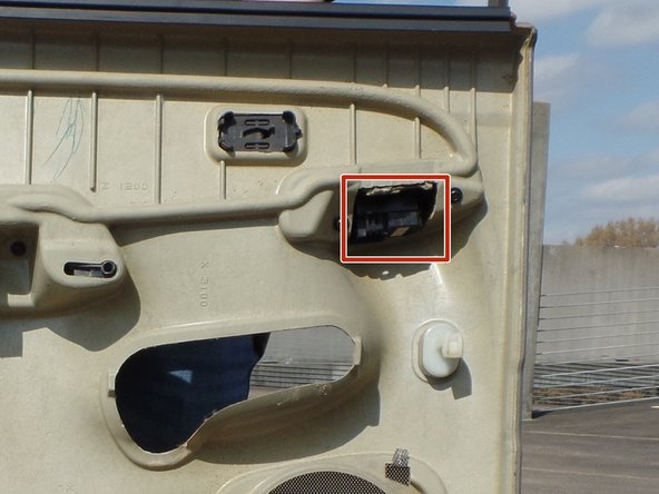

    4. 2005 GMC Sierra SLT 1500 Rear Passenger Side Window Motor Replacement, Unplugging the Window Switch: 步骤 4 中的图像 1,2 2005 GMC Sierra SLT 1500 Rear Passenger Side Window Motor Replacement, Unplugging the Window Switch: 步骤 4 中的图像 2,2
      • Using a flat head screwdriver to push in the clip, pull the plug from the window switch to unplug the window switch.

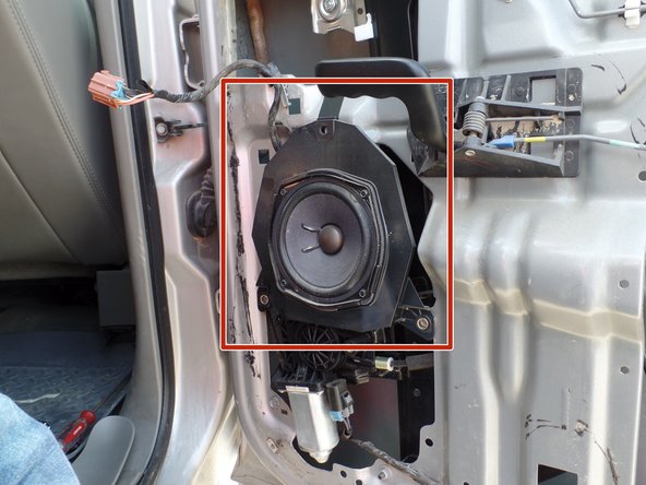

    5. 2005 GMC Sierra SLT 1500 Rear Passenger Side Window Motor Replacement, Unbolting the Speaker: 步骤 5 中的图像 1,3 2005 GMC Sierra SLT 1500 Rear Passenger Side Window Motor Replacement, Unbolting the Speaker: 步骤 5 中的图像 2,3 2005 GMC Sierra SLT 1500 Rear Passenger Side Window Motor Replacement, Unbolting the Speaker: 步骤 5 中的图像 3,3
      • Remove the (3) 10mm bolts from the speaker.
      询问修复机器人
      添加评论
    6. 2005 GMC Sierra SLT 1500 Rear Passenger Side Window Motor Replacement, Separating the Speaker from the Door: 步骤 6 中的图像 1,1
      • Pull the speaker out to separate it from the door.
      询问修复机器人
      添加评论

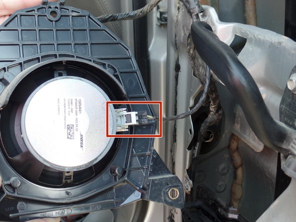

    7. 2005 GMC Sierra SLT 1500 Rear Passenger Side Window Motor Replacement, Unplugging the Speaker: 步骤 7 中的图像 1,1
      • Using a flat head screwdriver to push in the clip, pull the plug from the speaker to unplug the speaker.

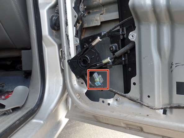

    10. 2005 GMC Sierra SLT 1500 Rear Passenger Side Window Motor Replacement, Unplugging The Old Window Motor: 步骤 10 中的图像 1,2 2005 GMC Sierra SLT 1500 Rear Passenger Side Window Motor Replacement, Unplugging The Old Window Motor: 步骤 10 中的图像 2,2
      • Pushing in the clip, pull the plug from the old window motor to unplug the old window motor.
