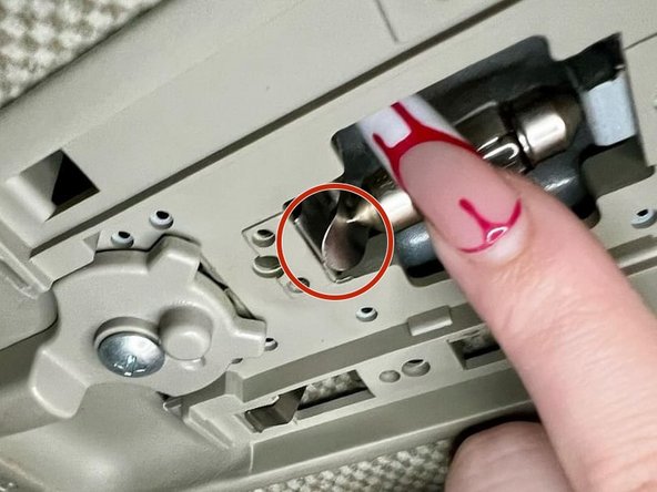

  3. 2004-2012 Nissan Versa Interior Dome Light Replacement: 步骤 3 中的图像 1,3 2004-2012 Nissan Versa Interior Dome Light Replacement: 步骤 3 中的图像 2,3 2004-2012 Nissan Versa Interior Dome Light Replacement: 步骤 3 中的图像 3,3
    • Push the tab away from the bulb to release the bulb.

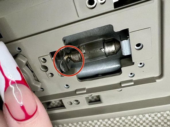

  4. 2004-2012 Nissan Versa Interior Dome Light Replacement: 步骤 4 中的图像 1,3 2004-2012 Nissan Versa Interior Dome Light Replacement: 步骤 4 中的图像 2,3 2004-2012 Nissan Versa Interior Dome Light Replacement: 步骤 4 中的图像 3,3
    • Replace the dead or broken bulb with a new bulb by inserting a side in the hole first then pushing it upwards past the tab to seal it inside.
    • The socket for a 2012 Nissan Versa is a DE3175 bulb.
    • In order to prevent burns, turn off the power supply before changing the lightbulb.Because the light bulb is fragile, you should use caution when inserting it into the socket to avoid breaking it.
