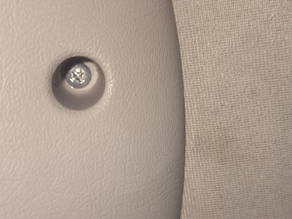

  1. 2000-2006 GMC Yukon Overhead Passenger AC and Light Panel Removal, Remove the screw at the base: 步骤 1 中的图像 1,2 2000-2006 GMC Yukon Overhead Passenger AC and Light Panel Removal, Remove the screw at the base: 步骤 1 中的图像 2,2
    • This screw is a non-captive, #2 Phillips machine screw.

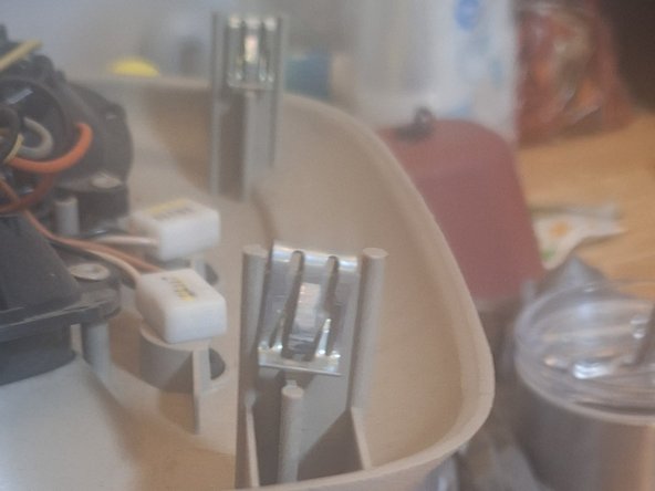

  3. 2000-2006 GMC Yukon Overhead Passenger AC and Light Panel Removal, Unplug the connectors: 步骤 3 中的图像 1,3 2000-2006 GMC Yukon Overhead Passenger AC and Light Panel Removal, Unplug the connectors: 步骤 3 中的图像 2,3 2000-2006 GMC Yukon Overhead Passenger AC and Light Panel Removal, Unplug the connectors: 步骤 3 中的图像 3,3
    • There is a locking tab on each connector.
