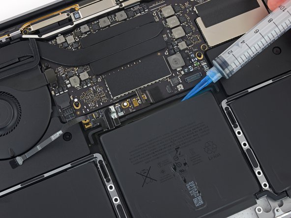

用这条指南来安全地用iFixit更换电池工具从你那MacBook Pro上拆除满是胶的电池。你的iFixit工具中的除胶剂可以溶化固定电池的胶,让你轻而易举地拆除电池。
“iFixit除胶剂非常易燃。”请在通风良好的地区做这件工作。在此过程中不要吸烟或是靠近明火。
注意:用来溶解胶的溶剂会损伤某些塑料。遵照所有这些指导并在涂溶剂的时候多加小心。
你所需要的
准备一个iOpener,把它放在触摸板排线上持续大概一分钟,来软化把触控板排线黏在电池上的双面胶。
如果你没有iOpener,可以用一台吹风机来加热排线。排线应该是热的,但不能热到没法碰。千万小心不要使电池过热。
要重新组装你的设备,请按逆序操作。

Does the replacement battery comes with the same strong adhesive as the original battery?
I ordered my battery for the 2017 version of the Macbook Pro with function keys from ebay and it didn’t came with a adhesive strip. I am sure you can use your own adhesive strips or double sided tape, as long as you mind the gabs on the aluminum frame,
Serj Nko -
Hi Jeff,
Thank you for this great work to beat Apple greediness. I followed the exact steps and everything went well, but my battery is not charging nor the status is shown on the bar! I tried restarting and resetting and even restoring and it did not work would that be something you can help me with?
If the old battery still works, try putting it back in, and see if that clears up the problem. If it does, the new battery is defective.
