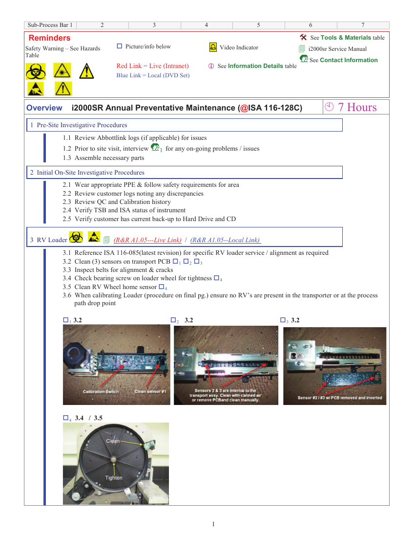

  • 3.1 Reference ISA 116-085(latest revision) for specific RV loader service / alignment as required
  • 3.2 Clean (3) sensors on transport PCB † 1 † 2 † 3
  • 3.3 Inspect belts for alignment & cracks 3.4 Check bearing screw on loader wheel for tightness † 4
  • 3.5 Clean RV Wheel home sensor † 4
  • 3.6 When calibrating Loader (procedure on final pg.) ensure no RV's are present in the transporter or at the process path drop point
† 1 3.2
2
3.2
3
3.2
† 4 3.4 / 3.5
