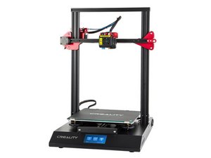

Why won’t the filament feed on my Creality CR 10s Pro V2
is the feeder motor activating? can you go into settings on the screen and make it feed by advancing it in the settings/refuel/ feed? if it will not feed at with that i would check voltage to the feeder motor and it no voltage that is the issue first. if it continues i would check the main board voltage. i have had the main board go out on one of mine.
