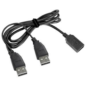

my iPod nano 1gen has a dead battery and it turns on when plugged with power adapter but it doesn’t turn on or sync when plugged with a PC, it shows only the screen of low battery.
If it was possible, I would use it without substitute the battery, but I would be able to sync in order to change the music I have in.
I tried with a cable like this https://images-na.ssl-images-amazon.com/... but even if I could turn it on, it isn’t recognized by my PC…
What can I do?

I don’t understand how use are using that cable on your mini as it doesn’t have a USB 2 port. Please look at this and tell us if you have the correct cable to either charge or connect to a computer
https://support.apple.com/en-us/HT201545
Also why haven’t you changed the battery out? I understand that it is very difficult repair. Here’s how to do it:

I have a normal charging cable (30 pin to usb), and I connect the 30 pin to the iPod and the USB port to the female of that cable, then I connect two male usb to PC in order to give the iPod more power. I did this because I thought that if I can turn it on with USB power adapter and I cannot turn it on with PC is because a USB of PC can't supply enough power. Then I use that cable which normal use is for external hard drive that needs external power supply. But I can't sync even if it is switched on.
I haven't changed the battery yet because if I could sync without substitute it, it would be ok for me to use the iPod only connected to AC. Otherwise I would be sure that it can read read Audible .aax audiobooks before substitute it.
